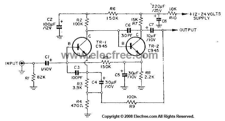

And example i have preamp
input is micro phone . how to i choose Ie for TR-1 , and TR-2 ?
The load is whatever this transistor circuit is driving.
A speaker is not 100k ohms but another circuit's input might be.
