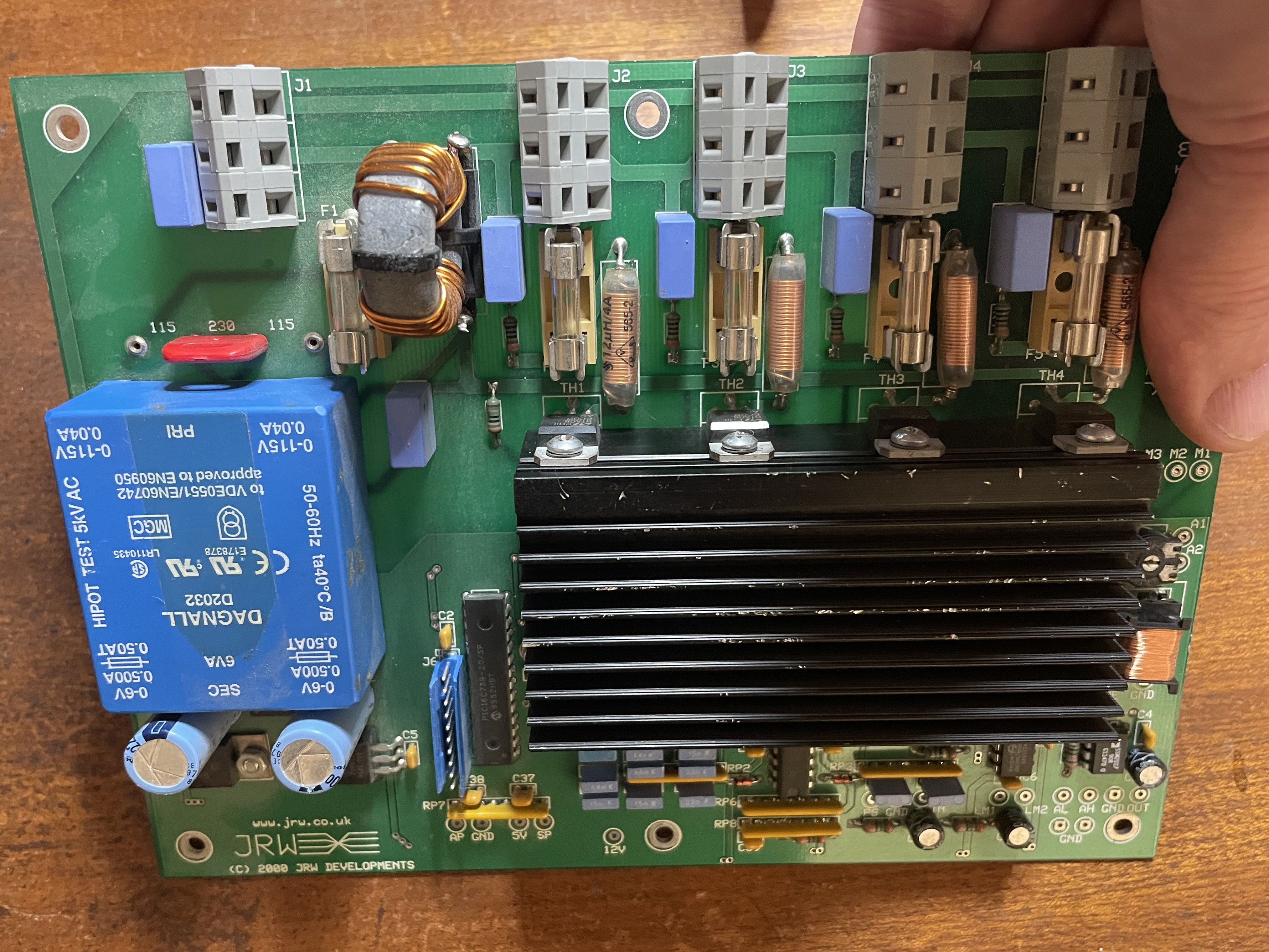

I wasn't expecting to be able to find one of these - a [rather battered] custom four channel AC mains light controller we did some time back. These run software PWM (phase control) at 256x half cycle frequency with a software PLL lock to 50/60Hz, on a 20MHz PIC16C73.

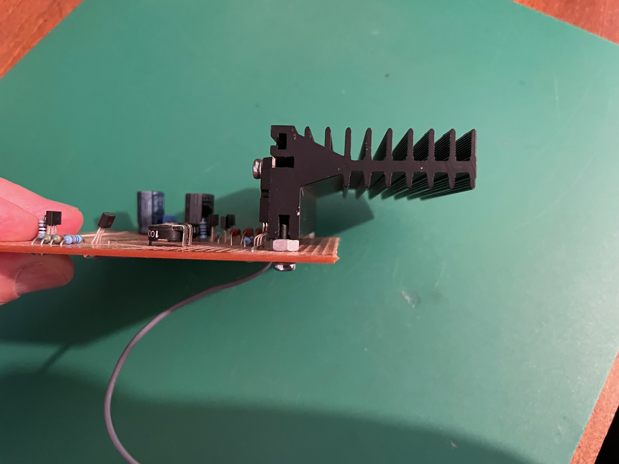

Serious heatsink - did it need it?, or was it something you had to hand?.
I suspect the ESP32 is considerably more than 4 times as fast, they are pretty speedy things, but as 'For The Popcorn' said, they do have a number of I/O restrictions and limitations.
They were a long run we did for a customer to drive arrays of filament lamps, up to 500W or more per channel with phase control in some products, though most were used with much lower loads.
The heatsink is not all that big, it's an "L" shape with the opto triac drivers etc. hidden underneath; same series as this one:
It's still a pretty big heatsink, losses in triacs are pretty low, so they don't usually need big heatsinks, and 500W per channel isn't a great deal. I used to replace a LOT of triacs in light units used in discos, when bulbs fail they commonly take out the triac on that channels. It was a nice little earner :D
They are convenient, and it makes the overall unit less prone to handling or shipping damage than with smaller flimsier ones.
It's also fused everywhere so pretty bombproof - and we always try to rate things way above the basic requirements to avoid failures in (mis)use.
We never had any warranty returns due to failed outputs as far as I remember.
PAR38's in particular were extremely prone to taking out TRIAC's, as with most incendescent bulbs they commonly go S/C as they blow - and special fuses (which 'might' protect the TRIAC's) cost considerably more than the TRIAC's did.
Nice heatsink though, and I'm fine with the extra mechanical protection it affords.
