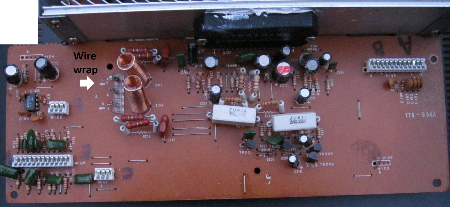

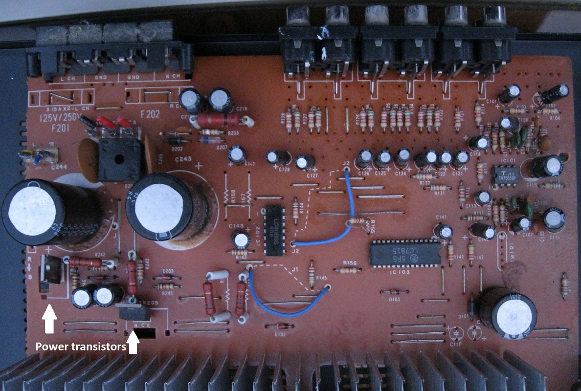

You're right about the wire wrap connections, see the photos. You'll note that I cut the wires off in order to remove the PCBs from the case.
I'll either solder them or insert modern plug connectors once I've located the faults.
As you can see, there are 2 transistors, one NPN & the other a PNP.
So I assume these are the + & - regulators. I'll trace out the circuit around them so I can fault find.

the power transistors in the first picture are your regulators, however, and the small glass diodes are most likely the zeners for them. the most common zener-transistor regulators bias the transistor base with a voltage 0.7 more than the rail voltage required. so a 15V zener on the base would actually give you a 14.3V rail voltage. that can be bumped up 0.7V by putting a forward biased diode in series with the zener. what you Should have on those transistors (approximately), looking at the transistor from the front, 1(B) 15.7V, 2(C) anywhere from 18V on up to whatever the main supply rails are on the big caps, 3(E) 15V. for the negative supply, make all of the voltages negative, but the pinout of the transistor is the same. and yes, they did as i guessed use the awful wire wrap technique....
