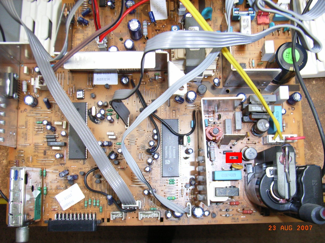

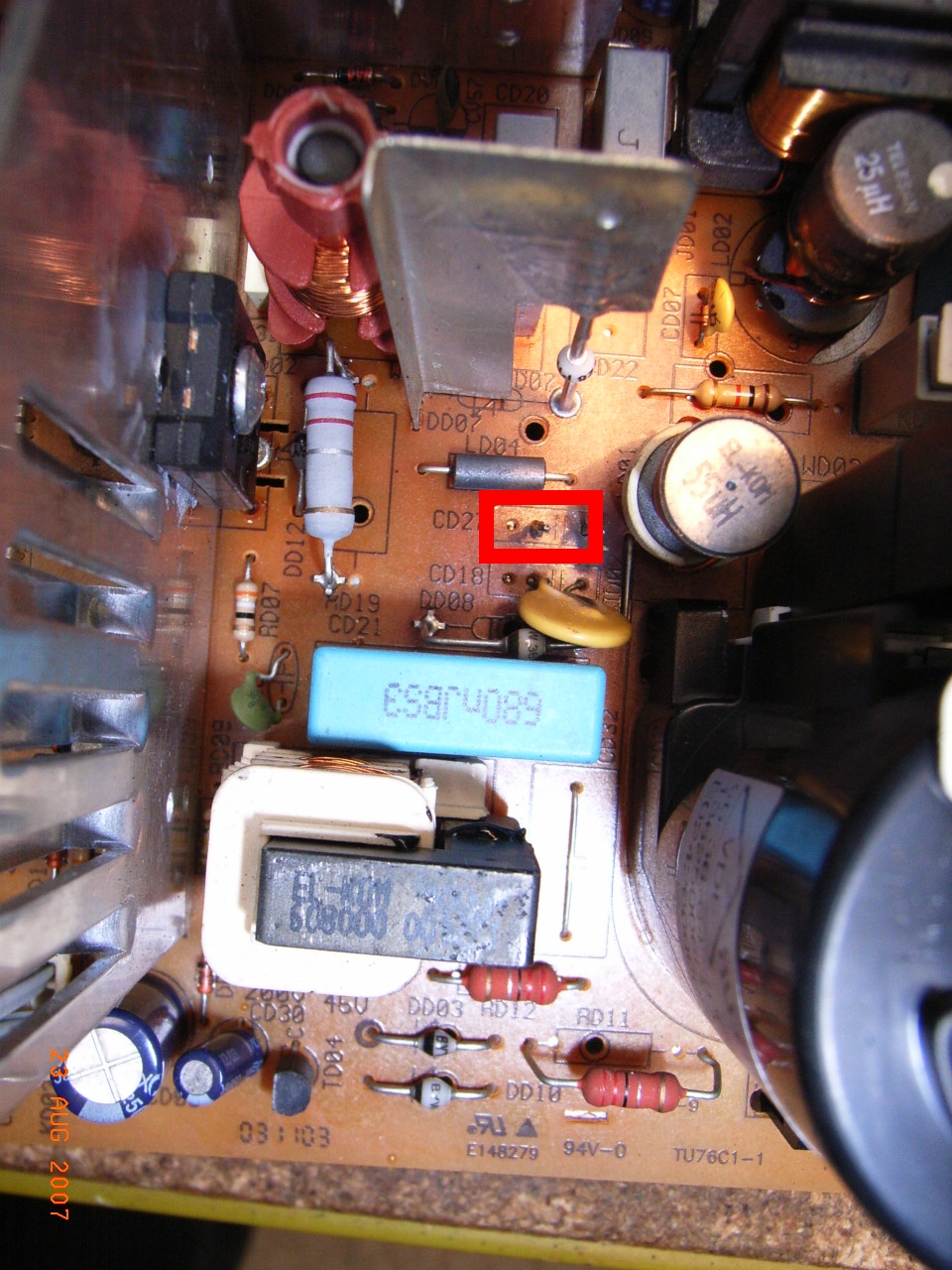

Now: I have a Sansui TV which has a blown ceramic capacitor (not sure if anything else is wrong at this stage). The capacitor has fried and I can't read all the markings. It has: BN, then next line, I think 222K, then next line ? V
Can SKS advise what other info I can give to the forum to hopefully receive some knowledgeable assistance? Would it help if I took a digital pic showing the location of the capacitor?

Yes, take a picture - you should also enter your location in your profile. The capacitor is 2200pF, probably 2000V or so, I'm assuming it's a small blue disc?.
Board Pics
Thank you very much for your reply.
Here are 2 pics: the first is the circuit board and the second is a close up showing more detail. In both pics the location is bounded by a RED BOX.
The capacitor is (WAS) a small brown disc abt 10mm diameter.

Professor Cyclops said:
Many thanks Nigel. What's the possible damage if I put it in and it isn't the right one??????
The capacitor was clearly labelled 2200pF, and 2KV is the usual voltage of the line output tuning capacitors - so there shouldn't be any damage. If it's too low a voltage the capacitor will probably fail S/C instantly.

The result
Hi everyone - welcome Heavyside.
Well, I put in the capacitor Nigel suggested as follows:
2200pF (.0022Uf) 3Kv The EIA code is 222.
Result was perfect: telly is now going well. Afraid I haven't tracked down the schematic.
