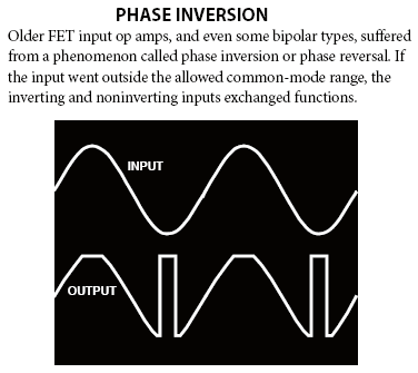

the input and output will be like this...
pic is here...
how can i do this? what will be the circuit? plz help as I do not know much about these ...
Your picture is just a little red x on my computer. only certain types can be attached.
There is no picture there.
The "picture" is not attached here. It is a link from flickr.com that does not exist there.
When I attach an ordinary small PNG file type image then its shows as a red x here instead of as a thumbnail picture. When I click on the red x then the full size picture appears. Here is my attachment:
EDIT: Now it does not show a red x but it also does not show a thumbnail picture.
I have added the pic. link, its now working. :)
