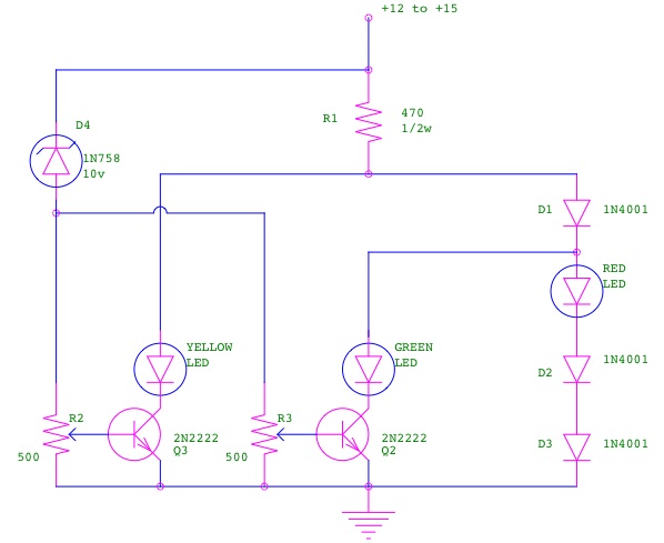

I found this circuit for a 3 LED voltage indicator that is pretty much what I need. But since it is from 1991 I wanted to know if it is still the best way to show the voltages or if perhaps there is a chip or something that will do it better/easier.
The goal is to have a small indicator that
lights just the Red LED if the voltage is below about 12.5 volts,
the Green LED begins to light at about 12.5 and the Red LED fades,
at about 14.25 the Yellow LED begins to come on and
by 14.75 the Green LED has faded out.
I like the simplicity of this circuit and that it could be housed in a very small case that I have found.
But any and all advice is appreciated.

Aside from being a little bit temperature dependent, it's a clever circuit. One caution; you should be certain that the potentiometers are never at their 'max' positions. If they are, you will toast the zener diode and the associated transistor.
That could be easily solved with a small series resistance I would imagine.
I think the circuit is not the best way to go.
The setpoints for yellow and green depend on each other too much and therefor the circuit is difficult to adjust.
You'd better off using a window comparator.

I want to thank everyone who has given me feedback on this circuit. And now of course I have a few more questions.
A note on the site where I found the schematic stated
Important: to simplify the circuit and improve
the performance, no protection was added to d4.
You must set r2 & r3 to ground before starting!
If they are adjusted to the d4 side, parts will smoke!
How would I ensure that the above release of the magic smoke could not happen?

Well, I am researching this as a possible circuit to offer to motorcycle owners. Big twin cylinder motorcycles have a hard time starting due to many reasons but one of them is that the riders park the bikes with the batteries half depleted. Then when they try and restart it overtaxes the batteries leading to premature battery failure. Many riders eat a battery a year which contributes tremendously to the safe disposal problem of lead acid batteries.
So the goal here is to produce a simple to understand easy to mount indicator that will help the riders extend the life of the batteries.
And that means cost effectiveness is important along with small size.

To protect the transistors and zener, put 100 ohms in series with the base of each transistor.

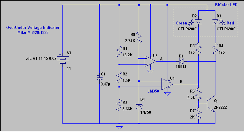

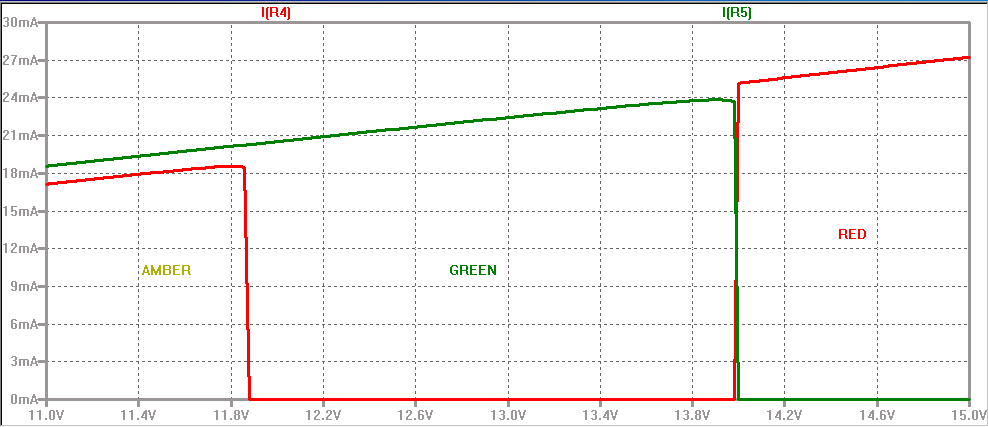

Another way to go. Something I did back in 1998 to tell me if my airplane alternator is charging. Has three states with one Bi-color common-anode LED; Amber if low, Green if good, Red if too high.
You can tailor the trip points by playing with R1, R2, and R3.
Today, I would probably redo it using an LM431 for the voltage reference in place of the Zener.

Thanks very much, I'll look into that.
Well I need the be able to make sure it is very clear to the rider when his battery is anywhere between 12.5 and 12.2 volts as that is often the area where they are when they get parked. Then over a week or 2 modern electronics have sucked them down another .2-.4 volts and that where they are when they next start. Then batteries get hosed due to being in a somewhat depleted state and the high current draw (like 52-55 amps for 1-2-3-4 seconds) required to start a large discplacement twin cylinder motorcycle.
So a window of 11-13 is too wide. And when a voltage regulator goes south they often overcharge the batteries for a while before they start blowing fuses and during that time the battery is being damaged, so I need to show the overcharge state also up around 14.5 V or more.
I appreciate the new ideas. But I think I will try this circuit out with the added resistors and I also need to add a relay so it will only get voltage when the bike is turned on.
Does anyone see any issues with adding a micro board sized relay?
If I don't add it then the circuit/LEDs will also slowly pull down the battery. Although I keep my bike on a float charger in the garage many motorcyclists are urban dwellers and have to keep their bikes parked on the street or where they can't get AC to a charger.
