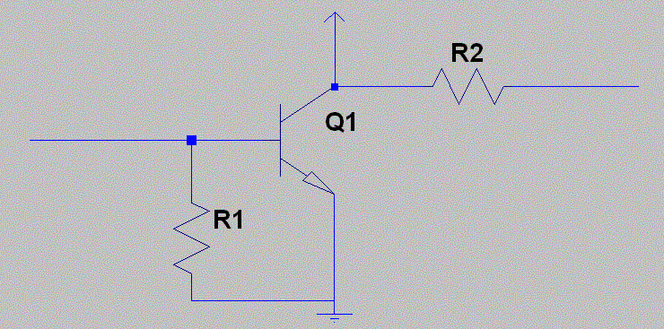

This is a very simplified amplifier (no biasing, coupling, etc). It is also a model: In real life, R1 and R2 would not be actual resistors.
R1 represents input impedance. If its too low, current will flow straight to ground, instead of going through the BE junction of Q1. If its extremely high, very little current will flow through R1, but more current will flow through the BE junction of Q1.
R2 represents output impedance. Obviously it should be low or not much current will get to the load.
So, an ideal amplifier has infinite input impedance and zero output impedance. Remember too that input and output impedance are not simply resistances, since the definition of impedance is resistance to an alternating current.
Hope this helped, it was the only way that i figured it out :lol:
