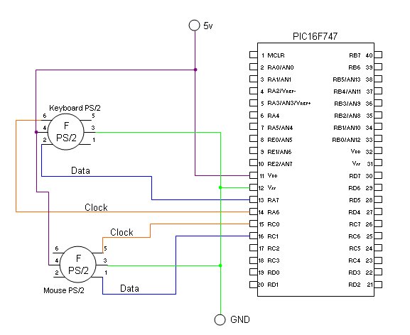

  • I have attached an image of a PS/2 port connected to a PIC and it shows some resistors and capacitors could anyone explain why they are there?
My guess is the Vcc is not at 5v, so that is the reason for the resistors. Am I right?

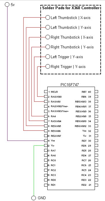

Thank you for your help I really appricate it. There are a few things that I would like to make sure that I understand. Please bare with me I am still learning.
  1. The minimum Vref for a PIC is 2.5v?
  2. Am I correct to say that +Vref and -Vref set the upper and lower limits for voltage range of analog pins?
  3. Since the range that I am interested in is 0v to 1.61v do I need to attach a Vref? If the range was 0v to 5v then I guess I would not need to attach anything to the Vref?
  4. Could I just set the internal Vref to 2.5v, if not why?
  5. I think the resistance value between the pots is 10k, so its not under 10k is that ok?
  6. When you ask about the resistance between the pots are you talking about the resistance between the upper voltage and lower voltage?
  7. I have included a drawing of how I was planning to attach the pots to my pic could you please take a look at it and make any changes if see something wrong?
Thanks.

After looking at that project you had made with connecting the PS2 port to a PIC I made my own diagram.
  • Would you please take a look at it and see if there is anything wrong with it?
I think it would help me a ton with learning this and progressing my project further. Thank you.

hi chem,
From the data sheets I use, yes.
Yes, BUT again there a limits to -Vref and +Vref, settings, they are descibed in the datasheet, IMO, not very well!.
EDIT:
A more accurate description of the +/-Vref action, would be: the +/-Vref values set the 'span' or 'slope' of the ADC.
No, just program the PIC to use the defaults, ADCON1, reg.
There is no way to do that. You can buy 2.50V ref devices, to connect to the +Vref input, they are powered from the +5Vsupply line.
Thats just at the recommended limit, no damage will be done if you connected a higher value resistance pot, it would just effect the ADC response/acquisition time.
Yes.
Will reply asap.
hi chem,
ref your dwg of the PS2 connector, are you reading the pin numbers in reverse order.?
my kbd datasheet says.
1. kbd clk
2. gnd
3. kbd data
4. n/c
5. +5V
6. n/c
On the Xbox dwg, remember the 0V connection from the Xbox to PIC pcb.
As a side point,, are you aware that the kbd data and clock lines are bi-directional? and open-collector.
Have you had a look at the keyboard 'key' coding requirements?

If you look at the basic schematic shown at:
There are a number of external components that "should" be used in general, however on a PIC you can basically get away without them. The idea is that the PIC needs to be able to put the line in two states: pulled low (with an output drive) or pulled high with a weak pull-up resistor, so that the keyboard/mouse can pull it low to send data. The PIC can do the former of course with a pin set as an output, and it can do the latter by setting the pin as an input with the internal weak pull-ups enabled. If the I/O pins you choose to use for the data/clock lines do not have internal weak pull-ups available, you would need to add pull-up resistors externally. Check the datasheet.
I don't see anything immediately wrong with your schematic at first glance, however I didn't verify the pinouts of the PS/2 connectors, and you of course need to check the pull-up thing I mentioned above.
More likely assuming the keyboard pinout is the mirror image of the mouse pinout. [edit](Probably thinking "Why else would there be six pins?")[/edit]
The truth is the mouse and keyboard pinouts are exactly the same. At work, I have a PIC with one PS/2 connector with only four wires attached. It has been used to test both keyboards and mice.
hi tk,
I dont quiet follow what you are saying?
As stated the PS connectors for mouse and keyboard are identical and there are only 4 active pins, hence only 4 wires?
If you check the OP's original drawing the mouse and kbd are labelled as a mirror image.
