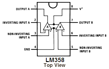

I am trying to make this work. I expect to get a 54 volt peak voltage from the points on the upper right side of the circuit. Instead I get 4 volts.
The circuit is calling for 2 LM358's, I have LM358N's
I THINK they are the same thing.. I have tried different LM358N's, they all do exactly the same thing.. I have gone over my work several times, and cannot find any deviations from the schematic. Any ideas gladly accepted..

Rebuild the circuit with only one LM358.
You are only using one half of each integrated circuit.
The circuit should generate a square wave with a frequency
of about 4 hurts. You should be able to see a led blink at
a rate of 4 times a second when connected from pin 7 to
gnd, with a 4k7 resistor in series with the led.
on1aag.
The second LM358 (U1A) does not have its power supply pins 8 and 4 connected to the power supply so of course that opamp doesn't work.
The LM358 has two opamps inside so only a single LM358 is needed for this circuit.
Next time you make a circuit, look at the datasheet for its IC.

palanisami said:
connect the 8th pin of U1A to 27 vdc and try once again
on1aag said:
And connect pin 4 to gnd !
on1aag.
I will give this a try and report back.. Thanks everyone for all the input!!
It says, "the first section and the second section of the dual opamp. One LM358 has both opamps inside.
Well that seems to have worked.. I am getting a much higher voltage fluctuation, my meter does not give me exact figures since it is switching polarity so quickly. .
Once again, thanks for the assist, you guys are great!

The project uses only a single LM358 dual opamp that is labelled U1. That is why its second section does not have power supply pins and that is why each opamp has different pins numbers.
