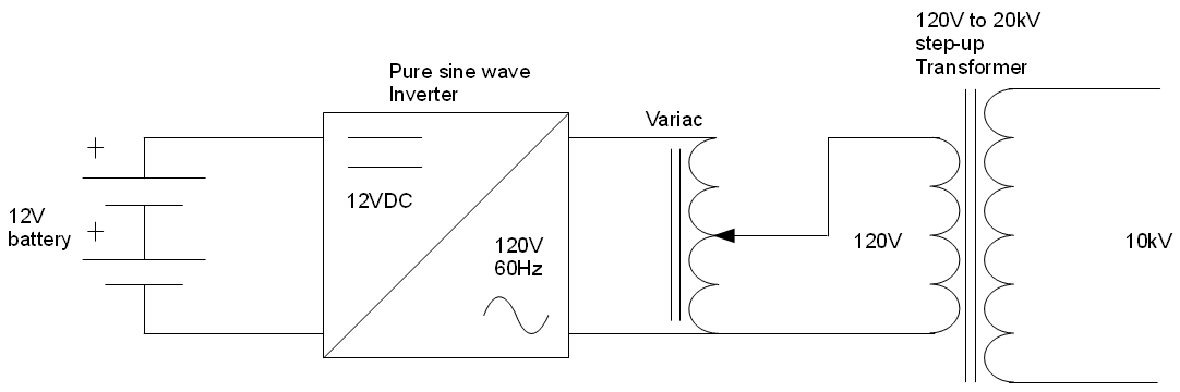

Hi all,
Since I'm starting in electronics, I'm looking for the schematics to make a DC to AC inverter.
I have a battery of 12 Volts, 7 Amp Hour, and I want to get an ouput of
+/- 23 mA, 10 to 20 Kvolts, AC PURE sine wave.
The values don't need to be exactly, for that reason I have written +/- 23 mAH and from 10 to 20 KVolts.
I know the best way to get that is buying a transformer, and plug it to my home AC plug. But I want to learn and it will be better to use a battery instead of using a plug in a home.Thanks.
What frequency do you need?
How long does it need to last for?
20kV@23mA is 460W which will require 46A of current from a 12V battery (assuming 80% efficiency) so your battery will last 9 minutes, probably less because its capacity will be under 7Ah with such a high current draw.

I would need 60 Hertz. If I use, 10 Kv, the battery will last more. The battery is 7 AH, but I can add more batteries in parallel. 3 could be a good option, but I know they will last few time.
Yes, with 10kV the battery will last twice as long: 18 minutes, if you're lucky.
The difficulty with this project, is not just the pure sine wave but the high voltage output.
The best way is to buy a pure sinewave inverter and connect a transformer to it.

To vary the voltage use a variac on the primary of the step-up transformer.
I don't know where you're going to find a 120V to 20kV transformer though, maybe you could rewind a microwave oven transformer?

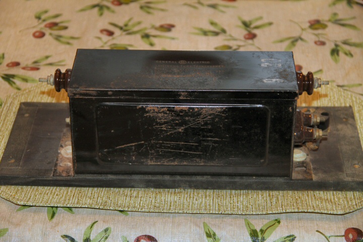

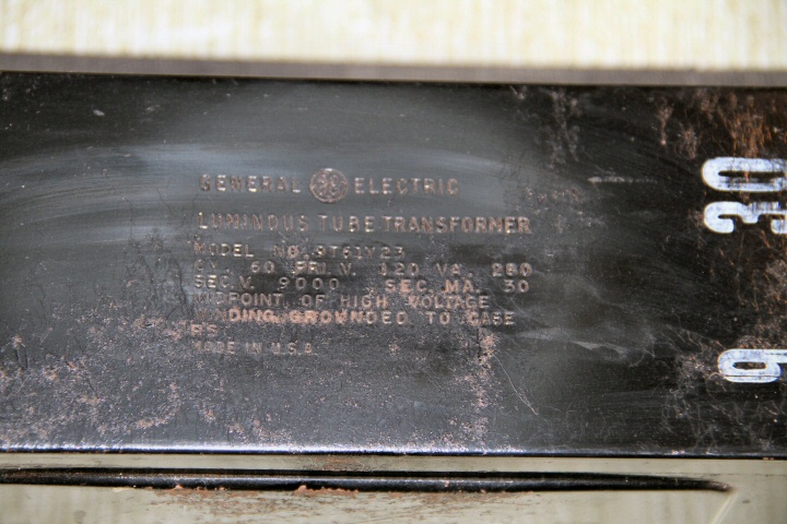

Attached are a few images of an old one I had laying around. I am sure TCMTECH can attest they get large and heavy. This one is a 9,000 volt unit 30 mA. I did have a 15 KV 30 mA one years ago. The problem with these things like the one pictured is that unless you are careful it will send you to the afterlife.
Whatever your little project is I strongly suggest you be real careful! Brute HV transformers like this have no safety features and there is no current limit other than your body resistance. It can, again, make you dead!
To function this transformer needs a 120 VAC 60Hz sine wave. Therefore you would need to drive it with a true sine output inverter. Good luck!
