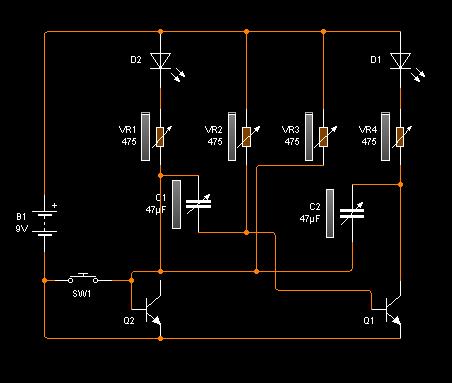

I use Livewire to simulate circuits.
I've attempted to apply this circuit numerous times but can't get the LED's to blink.
Any suggestions?

It could happen for real. The simulation program thinks the transistors, resistors and capacitors are exactly the same. Both transistors turn on at the same time. Then the circuit latches instead of oscillating.
You need to do something to make one transistor turn off for a moment to kick-start the oscillation.
So if I put a push to break switch on the base of one transistor and broke the 'latch' it should start to oscillate?
This could also happen on a breadboard too couldn't it?
This simple circuit is called a multivibrator. Some articles on the web say it is possible that it will fail to start oscillating.
Try adding a pushbutton to short a base to ground to start it.

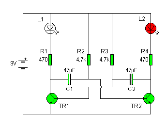

This is what I've done. Even when one transistor base is shorted to ground, the lights don't begin to blink. They just stay on.

Q2 in your second schematic is connected incorrectly.
Livewire should have an Initial Condition operator (component, etc.). In Spice, the command is
.ic v(b1)=0
which forces the voltage on the node named b1 to zero while the initial operating point is computed.
If you can set the initial condition of one of the bases to zero, the multivibrator will start.
You could also apply a short current pulse to almost any node to upset the equilibrium.

Make the gains of the transistors, the values of the resistors and capacitors all slightly different, then it'll probably work.
