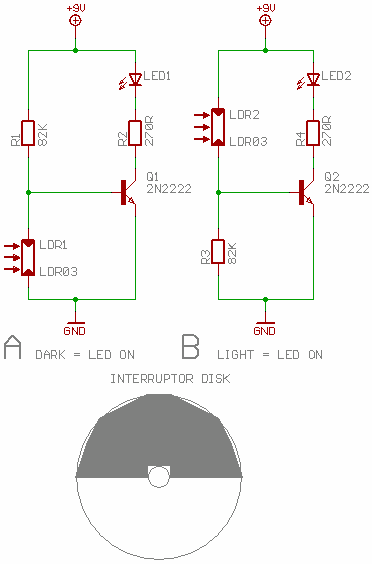

Hi airman,
you might try the circuit modified for an LDR. Basically you can use any LDR.
The example is calculated for the commonly used LDR03, which has a resistance of about 1KΩ when exposed to bright light and 5 - 13MΩ in the dark.
The dark resistance changes as follows: 1 sec/100KΩ, 5 sec/300KΩ.
ton=50ms, toff=35ms
The LDR05 is slighter faster (ton=35ms, toff=25ms) and has a higher dark resistance of 11 -40MΩ.
Making the photo interruptor with an acrylic glass disk, one half painted black, will result in equal dark and light time, giving the LDR more time to react. (change resistance)
Attached are two example circuits which you might select according to your desire.
Motor rpm recognition should be possible up to 700rpm.
The transistor symbol means: base=vertical bar, emitter=arrowed slanted pin, collecor slanted pin.
Boncuk

That depends on the power demand of the buzzer. LDRs can stand max 90mW (Vmax=150V).
If the on resistance gets low enough it should work.
Never tried though.
Good suggestion.
Yes, you can get piezo buzzers which only require 5mA, even even the CdS cell has a light resistance of 100R the voltage drop will only be 0.5V.
