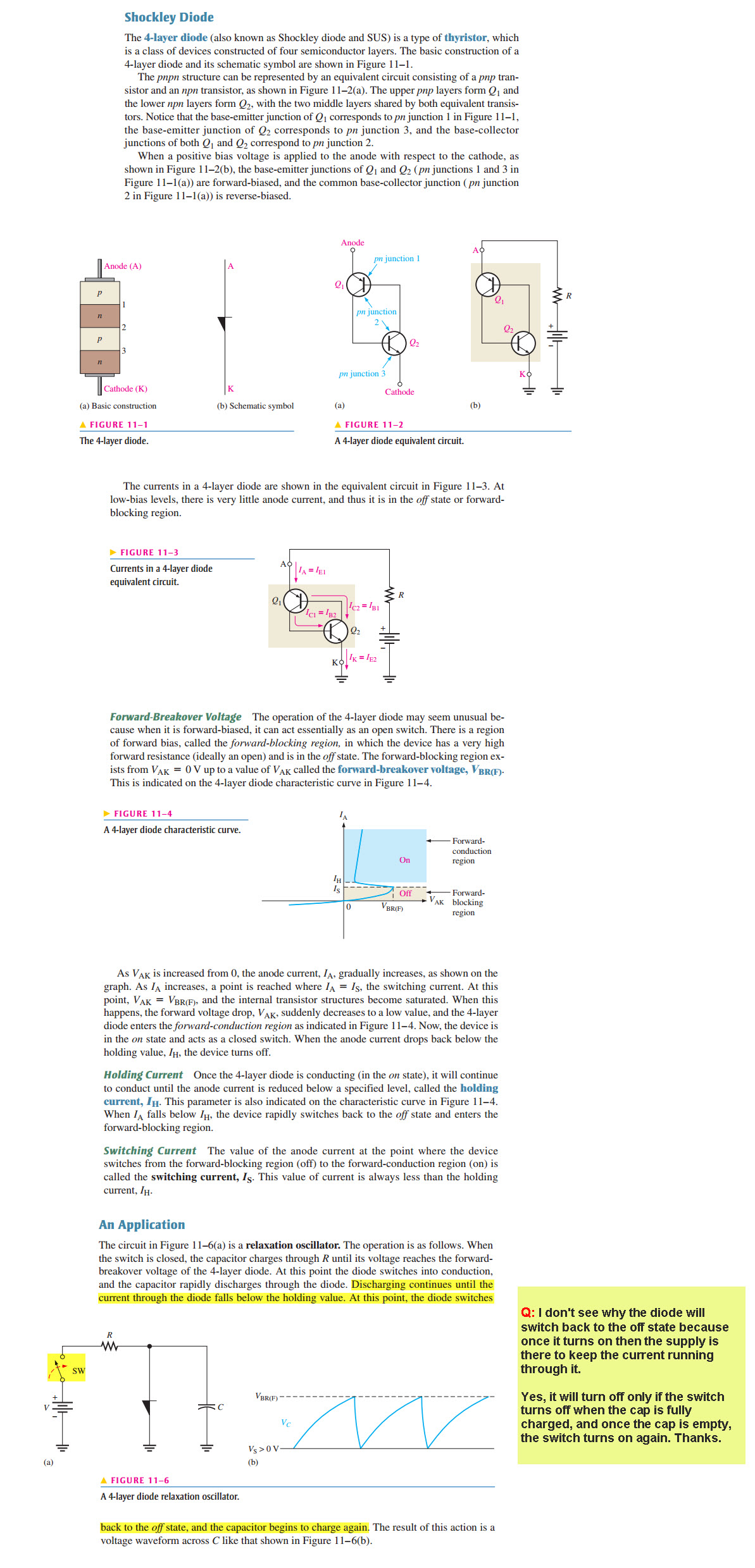

Hi
Could you please help me with this query about Shockley diode? Thank you.
Regards
PG
PS: For etymology of the words "thyristor" and "thyratron", please have a look on **broken link removed**.

hi PG,
The current flowing thru the resistor and diode [ when the cap has discharged] is less than the required HOLDING current of the diode, so it turns off.
Look at this pdf.
E
  • CD00003853.pdf
Thank you, Eric.
The following definition from the PDF is very helpful.
To keep an electromechanical relay turned on, it is necessary to have a minimum current circulating in its coil. If the current falls too low the relay would turn off. The same phenomenon can be observed in a TRIAC. This minimum current which keeps the TRIAC conducting is called the hypostatic or holding current, IH.
Regards
PG

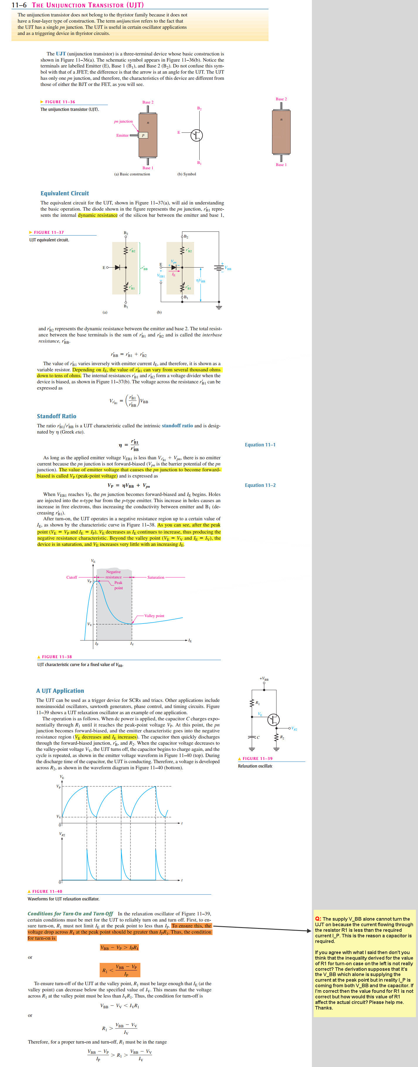

Hi
Could you please help me with these queries about a UJT (unijunction transistor)? Thank you.
Regards
PG

hi PG,
This pdf explains the valley voltage characteristic of a UJT
Dont forget the UJT is formed using a 'semiconductor' material, so it will have an intrinsic resistance from B1 to B2, usually around 10K
E
  • unijunction-transistor.pdf
Thanks, Eric.
I understand this but it's an n-type material which means it has some free electrons which means a bad conductor, and a bad conductor isn't really such a good insulator that it can offer resistance of 10 kΩ. I know I'm missing something here. So, I still need a little more help with Q1 here, and if possible, please do let me know if my interpretation in Q2 is okay.
Regards
PG

Just a quick note here...
I see a lot of questions about the unijunction transistor. These transistors are rarely used these days. I have only encountered one real circuit that had one in it in the last 40 years. There may still be schematics around though and there's a chance someone somewhere might use one, but i think it will be very rare.
