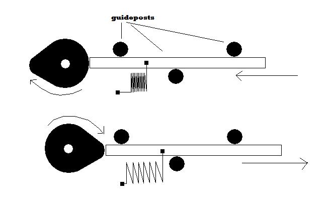

Another way to do this, same principle as the crankshaft but somewhat different, would be an obtusely shaped cam.
A rod guided by a track or guideposts of some sort is held against the rotating cam by a return spring. As the more obtuse (longer) part of the cam is turned by the motor (usually gear reduction), it pushes the rod and stretches the spring, moving it outward in a linear fashion. As the cam moves around toward the shorter, rounder part of the cam, the spring pulls the rod back to its original position.

A properly design "pin in groove" cam can push and pull, and can have a cam shape to give more linear force than a crank, but the crank wins outright for ease of build and reliability. If he can use the middle portion (say 50%) of the stroke range it will be close to constant force.

Had some time, so I drew up a diagram for the linear cam model.
Maybe someone can use it.
