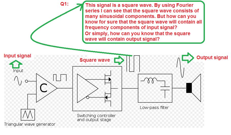

Please help me with these questions:
Here is an article about class D amplifier in wikipedia: https://en.wikipedia.org/wiki/Class-D_amplifier
class-d-amplifier-modified-jpg.75353
Basic operation
Class D amplifiers work by generating a variable duty cycle square wave of which the low-frequency portion of the spectrum is essentially the wanted output signal, and of which the high-frequency portion serves no purpose other than to make the wave-form binary so it can be amplified by switching the power devices.
A passive low-pass filter removes the unwanted high-frequency components, i.e., smoothes the pulses out and recovers the desired low-frequency signal. To maintain high efficiency, the filter is made with purely reactive components (inductors and capacitors), which store the excess energy until it is needed instead of converting some of it into heat. The switching frequency is typically chosen to be ten or more times the highest frequency of interest in the input signal. This eases the requirements placed on the output filter. In cost sensitive applications the output filter is sometimes omitted. The circuit then relies on the inductance of the loudspeaker to keep the HF component from heating up the voice coil. It will also need to implement a form of three-level (class BD) modulation which reduces HF output, particularly when no signal is present.
Q2: Please help me explain the bold sentences? Why those frequencies help ease the requirements placed on the output filter?

If two frequencies are widely spaced (e.g. one is ten times the other) it is much easier to separate them than if they are close together.

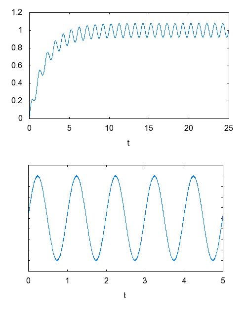

A simplified radio frequency modulator output is:
Vout=(1+cos(wm*t))*sin(wc*t)
where wm is the message signal angular frequency and wc is the carrier frequency angular frequency, and wm is always much less than wc. This reduces to:
Vout=sin(t*wm+t*wc)/2-sin(t*wm-t*wc)/2+sin(t*wc)
where we see the sum and difference frequencies and the carrier frequency. But this produces waves that are above and below zero at the carrier frequency.
In a PWM system like yours it's a little different because the half cycles are always above zero or below zero and follow the input wave shape, and this is a little difficult to think about it terms of frequencies but we can use a rough approximation to see what happens. The function we can use is:
Vout=(1+cos(wm*t))*(1+sin(wc*t))
and that reduces to:
Vout=sin(t*wm+t*wc)/2-sin(t*wm-t*wc)/2+cos(t*wm)+sin(t*wc)+1
were we can quickly spot the cos(t*wm) term, and that component is at the original input wave frequency.
If we filter this with a simple RC filter we get a wave that is always above zero but looking at the sinusoidal part alone we definitely see the original wave frequency as the diagrams below show.
In the diagrams, the carrier was 100Hz and the message signal was at 1hz. The one above is the actual output of the RC filter, and the bottom picture is the AC component amplified for clarity.

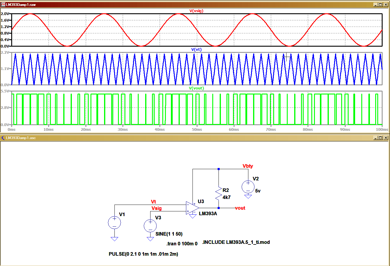

hi anhnha,
Look at this plot of the comparator modulator, its very basic but it shows the modulated output.
The signal in is a50Hz sine wave and the triangular is approx 500Hz.
The modulated signal would be connected to a Res Cap demodulator.
E
EDIT: Changed the image to show the correct sine inp to mod output in same Phase.

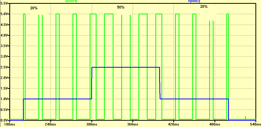

PWM signal is nothing more than a square wave. Also the PWM average voltage is equal to:
Vavg = D *Vpeak Where D is a duty cycle D = Ton/(Ton + Toff). For example if we have 5V square wave with 50% duty cycle the average voltage is equal to 2.5V. To create average voltage from a PWM signal we use a low pass filter.
In class D amplifier comparator create at his output PWM signal proportional to the input signal. The larger the input signal the greater the duty cycle and vice versa.
For example if we have a 1V at the input, the PWM output duty cycle will be equal to 20% for 5V supply. If we change Vin to 2.5V the PWM duty cycle will change from 20% to 50%.
And if we back to 1V the PWM duty cycle will back to 20%.
And after the filter we get our original signal.
0.2*5V = 1V
0.5*5V = 2.5V
0.2*5V = 1V
So if input signal is a sine wave the PWM duty cycle will constantly changing in the rhythm of the input sine wave.

hi anhnha,
E
0.2*5V = 1V
0.5*5V = 2.5V
0.2*5V = 1V

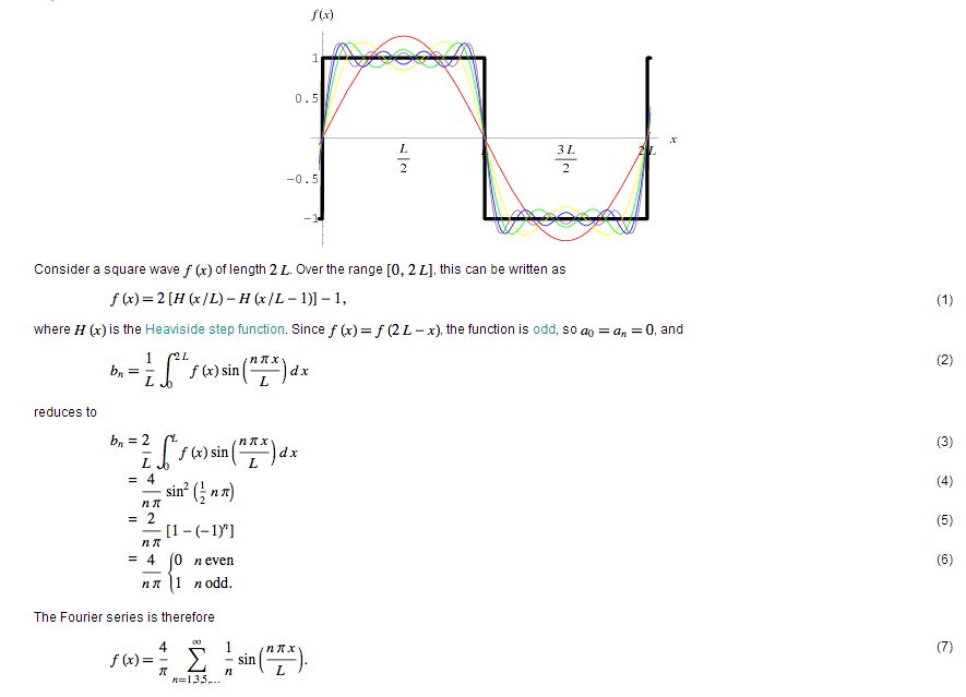

Thanks MrAl,
I think you what meant can be illustrated by this picture:
fourier-series-of-a-square-wave-jpg.75370
I got it. But how about other cases:
1. Input signal is a single sinusoidal signal but triangular wave has higher frequency.
2. Input signal is a baseband signal with a range of frequencies and triangular wave has high frequency

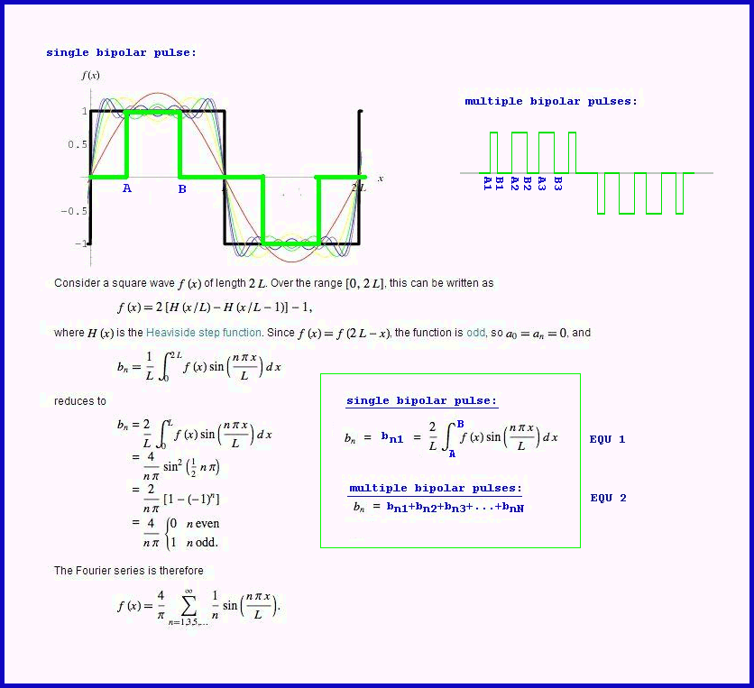

Hello again,
For a single bipolar pulse as shown in the attachment we simply change the limits of integration:
[LATEX]b_n=(2/L)\,\int_{A}^{B}\mathrm{f}\left( x\right) \,\mathrm{sin}\left( \frac{n\,\pi\,x}{L}\right) dx[/LATEX]
For multiple pulses as shown in the attachment we have to integrate over each pulse individually and add up all of the results:
bn=Sum(bnN over all k pulses)
[LATEX]b_n=\[\sum_{k=1}^{N}\mathrm{b}\left( k\right) \][/LATEX]
However we may have to also calculate the 'an' as well so we can account for the phase shifts (not shown in the drawing). When in doubt calculate those too and see if they are all zero or not.

hi anhnha,
This is the point I was trying explain in my post #5.
The pulse width reflects the instantaneous amplitude of the 'audio' signal that we wish to amplify in the 'D' class amplifier.
The Comparator output is a result of comparing the audio signal and the triangular 'sampling' frequency, which is a square wave of constant amplitude but with a varying pulse width.
This square wave is amplified in the 'D' class amplifier and is output as a square wave of greater amplitude.
To recover the amplified original audio signal the square wave signal is demodulated using a filter, usually a resistor/inductor capacitor network.
Consider the amplifier has to accept 'audio' over a range of 50Hz thru 10Khz, as shown at the highest audio frequency of 10KHz the triangular frequency would have to 100KHz.
ie: a ratio of 10 to 1.
As its only a 10:1 ratio, its not easy to 'faithfully' recreate the 10KHz audio signal due to the time constant constraints of the R/C demodulator
At lower frequencies the ratio becomes higher, so the audio signal will be closer to to original signal.
I realise you are seeking a mathematical solution, but I would say its important to bear in mind what is the purpose of the circuit.
Eric
