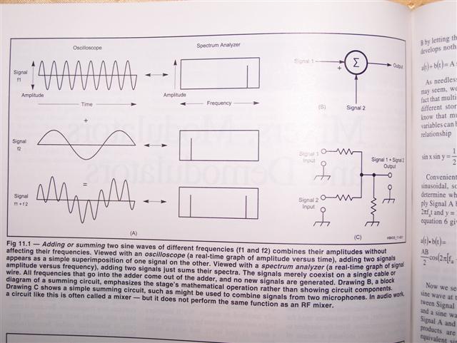

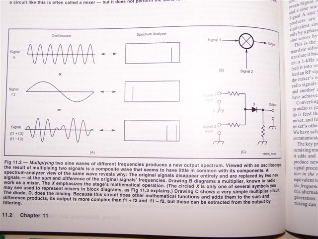

I don't know how else to say it other than you are wrong. To simplify, you supply two frequencies to the input of a modulator, and get two completely different frequencies on the output. That is not linear. Mixing is the function of multiplying the inputs which is not a linear function. The rectifier you refer to does not have an output that is directly proportional to the input. maybe the attached pictures will help you understand.
Sig239 said:
Linear: having or being a response or output that is directly proportional to the input.
You showed an AM modulated carrier. The peak voltages of one polarity of it (the modulated carrier that is rectified) are a perfect copy of the modulation. You can even see it.
The multiplication and non-linearity occurs on the carrier and its sidebands, not to the baseband.

The book seems very badly written?, to suggest that the two original frequencies disappear is nonesense!. The output of an RF mixer is the sum, the difference, and the two original signals. IF it's a double-balanced mixer then the originals will only have very low amplitude, and (theoretically) could be non-existant. However, the crude diode mixer ISN'T balanced at all.
As an example of AM, if you have a 1MHz carrier and modulate it with a 1KHz sinewave you will get three output signals.
1,000,000Hz - carrier
1,001,000Hz - sum
999,000Hz - difference
There will be no 1KHz output as it won't pass through the RF stages.
