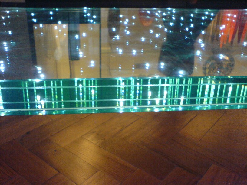

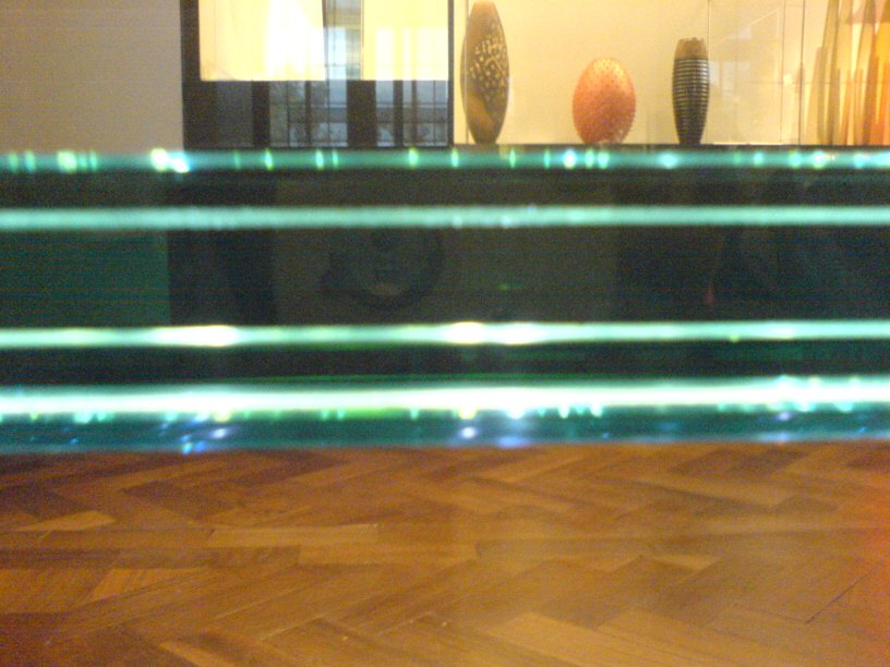

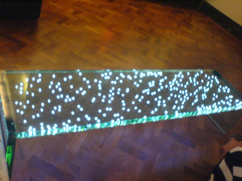

This clear conductive material is really interesting. I saw it being used in a glass table to supply power to Surface Mount LEDs. They even went so far as to route the supply down the leg and into the floor so no power connections can be seen at all - very impressive. The table was made by Ingo Maurer. Attached are some photos I took of it at the V & A Museum in London. I'd like to try and make something like that one day.

I could use one of those as a starchart with my little starship miniatures to plan out my strategy for galactic conquest.
