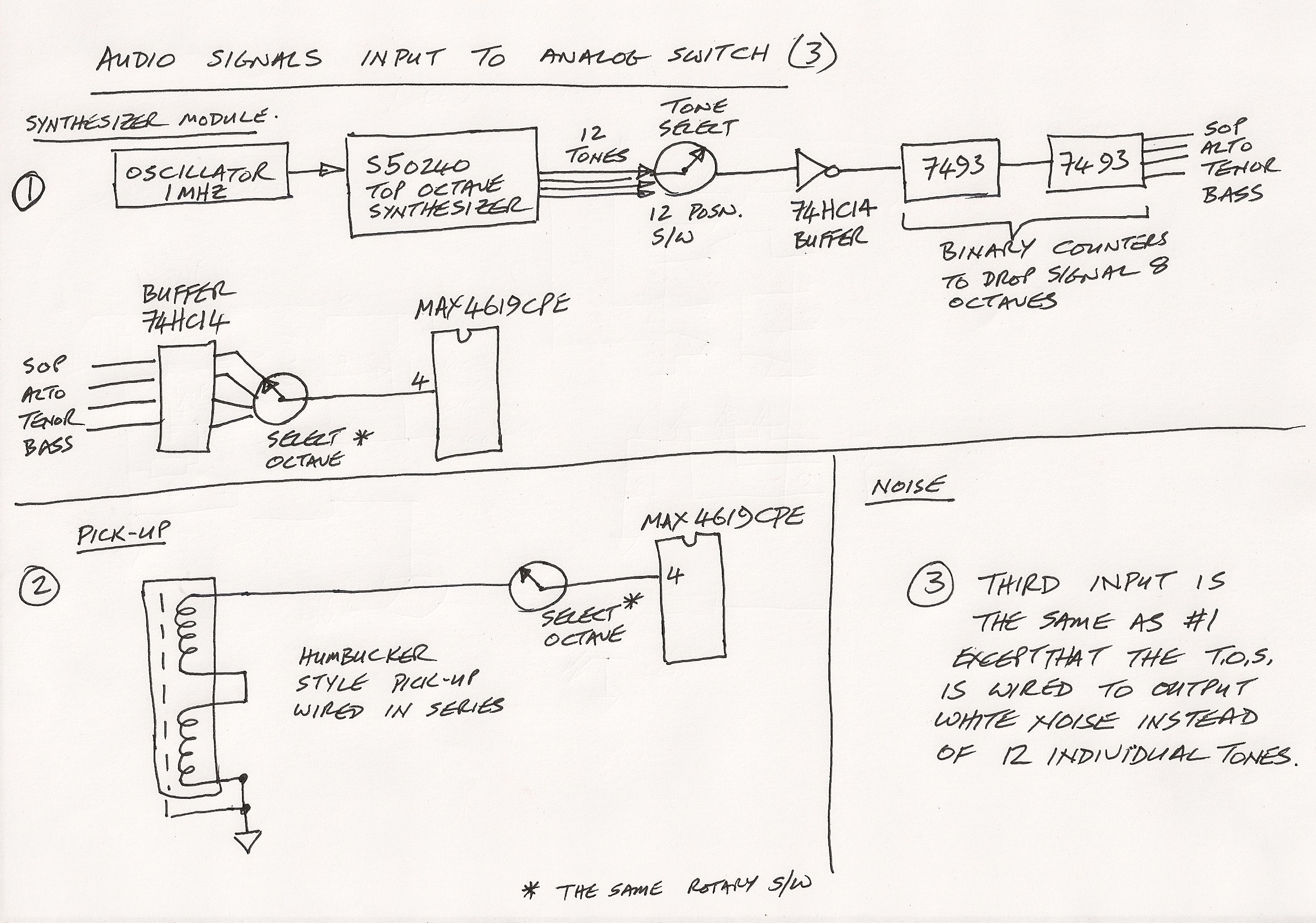

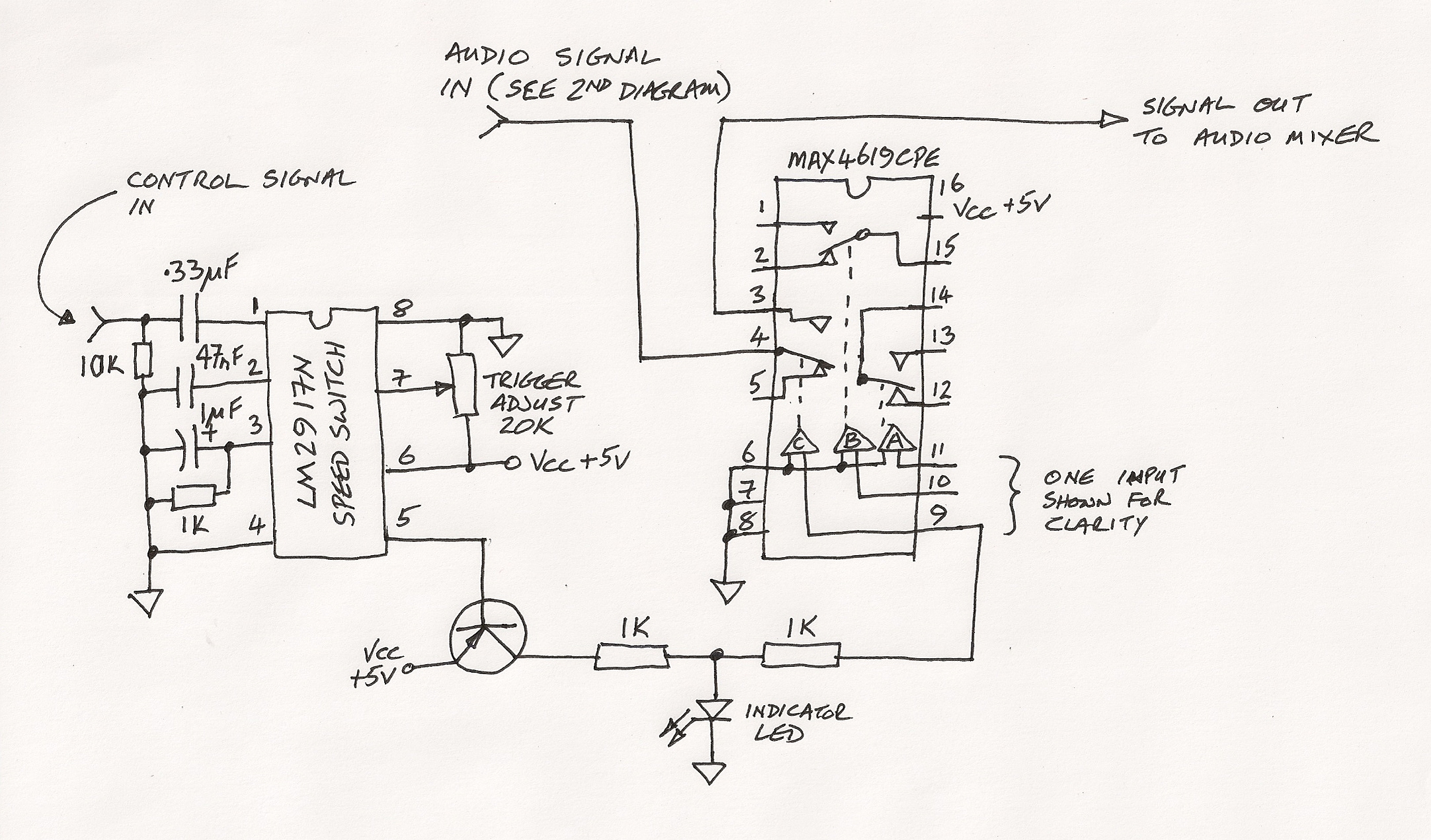

I've attached a couple of diagrams of the relevant parts of the circuit; one showing the analog switch control system and the other listing the three different analog signals passing through the switch.
What am I building? The circuit is being used in the yellow instrument shown in the photo; it is used as an electronic rhythm generator replacing the string on the acoustic version. A series of small holes are drilled around the perimeter of the wheel and these act as an on/off for an IR LED and a sensor. The wheel speed (frequency) is monitored by a LM2917N speed switch that triggers when the crank is accelerated. This acceleration is a brief pulse and is controlled by the musician; it connects pin 5 of the speed switch to ground and is used to activate the analog switch. The analog switch in turn has a selection of inputs that will pulse when activated and link to an audio mixer (along with the melody and drone signals) and out to the amplifier.
Switching frequency is low, >20Hz maximum and audio signals will be under 20KHz.
The instrument is built and the control part of the circuit seems to work fine. I mentioned that there was a capacitor in the input line to the analog switch. Sorry, I made an error. The cap is at the input to the speed switch; there are no caps on the input lines to the analog switch.
I realise that there are probably several errors in the circuit design. If someone would kindly correct my faults I'd be most grateful. Many thanks!

I don't know if this will help. I made a 4-channel aircraft intercom several years ago and during the initial design had the "click" problem each time the VOX switched in a channel. By biasing the capacitive-coupled input amps at Vcc/2 and also the capacitive-coupled output of the analog switch at Vcc/2, the click problem disappeared.

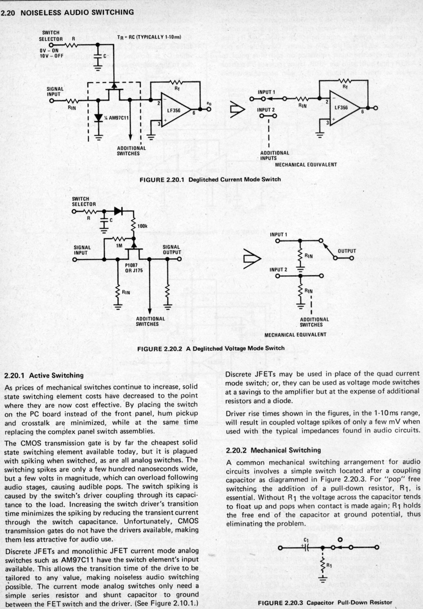

From the data sheet, it looks as if the MAX 4619 is of similar construction to 4000 series CMOS analogue transmission gates like the 4066 or 4051/52. If that is so it is very difficult to eliminate all the switch clicks. Slowing down the 'gate' turn on time is not an option with this type of analogue switch. The attached jpeg, from a very old National audio data handbook, shows some of the detail of the FET alternatives - and describes the transmission gate limitation.
Having said that, it is possible to get pretty close to silent switching from these ordinary analogue switches, if you follow KMoffett's suggestion of maintaining a fixed DC high resistance 'half' rail' bias, on both sides of the switch - and capacitively couple the signal in and out
The other problem you have, from the diagrams you have posted, is that it appears that you are switching the output from the pickup directly into the analogue switch. I'm guessing there's quite a lot of gain after that, and even with the DC bias problem dealt with, the remaning switch 'clicks' are going to be magnified --probably to an unacceptable level.
Ideally, you need to do the switching after the pickup gain stage -it's going to be very difficult (if not impossible) to get rid of the switch clicks otherwise.
