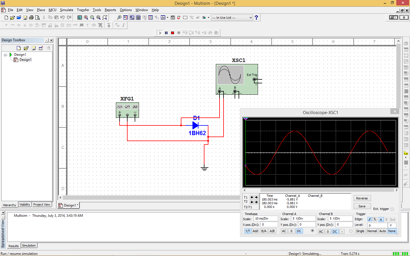

First i admit i am weak on basics.See the image, i am measuring the voltage across the diode.Actually it only passes positive wave,but it also passing negative value.what i misunderstood here.
What image?
sorry,see this

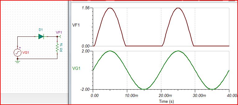

Try connecting a 1k resistor in series with the connection from the + output of the generator and the diode.
Then re-run your computer game.
Your circuit wired this way:
might make the need for the 1k resistor (a "load", a necessary component) somewhat easier to see.
Google "simple rectifier circuit".

Can you please explain me the following things
1)Why there must be load resistance,why the diode is not clipping the negative half with out load resistor
2)I cannot differentiate the source ,is that function generator or ac power supply.
3)Let as assume in the above circuit the ac power source is 24 vrms(12v amplitude) 60 hz.if i replace the same with function generator with sin wave of 60hz and amplitude of 12 v
Like you were told on the other two or three websites, your signal generator is a fake simulation that is not real. It has ZERO output impedance so its output signal is not affected when shorted by the diode. A real signal generator output impedance is 50 ohms or more then the diode will cause clipping.
You can also simulate a fake 24V RMS 60Hz signal with ZERO output impedance that will do the same thing. But if you use a realtransformer to supply the 24V RMS then the transformer, the diode or both might blow up or catch on fire.
thanks i got that,even though the diode is shorted it have small resistance that make the sine wave appear in output ,right

If you measure the current through the diode you will see the problem. The current goes to a very high level with no external resistance added. Also note that the current is rectified. A diode rectifies current not voltage.

A real simulation works the same an actual circuit because it has all the spec's for devices. The signal generator in the original simulation was faked because its output impedance was zero and it could supply thousands of Amps of current.
Also the diode was faked because its forward voltage reached 5V when it had thousands of Amps flowing through it.

Simply put, much like a resistor opposes current flow a diode only allows unidirectional current flow, it only allows current to flow in one direction.

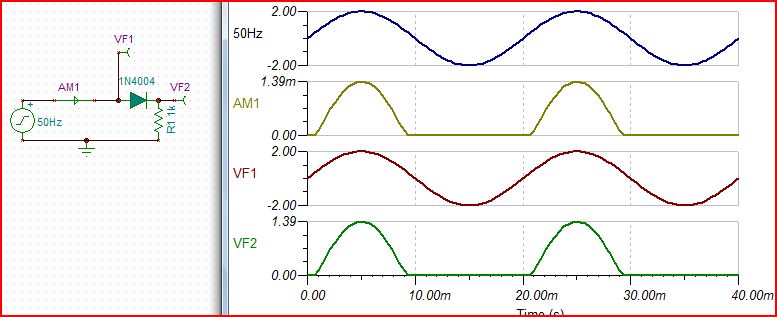

Perhaps this circuit will help you understand once you're comfortable with the above concept(s):
AM1 is an ammeter.
Briefly, the current (I, measured by meter AM1) passing through the resistor (and the diode) generates the voltage level (VF2) across the resistor as observed in the graph above.
Note the simultaneous peak positive value difference between VF1 & VF2. That value is the voltage generated (by I) across the diode's resistance when forward biased, or in this case the positive going sweep of the AC signal. Note also that when the diode is reverse biased no current flows and thus AM1 and VF2 show, in order, zero current and voltage levels. During this period, VF2 merely reflects the voltage level of the no-load output of 50Hz sine wave generator.

The voltage is due to the uni-directional current caused by the diode that flows through the diode and resistor. So the observed clipped voltage is a result of the unidirectional current and the resistance. That's why you saw no clipping when there was no series resistor as in your original post.
You must think about where and how the voltage is being generated and how Ohm's law works. Voltage and current are related entities.
