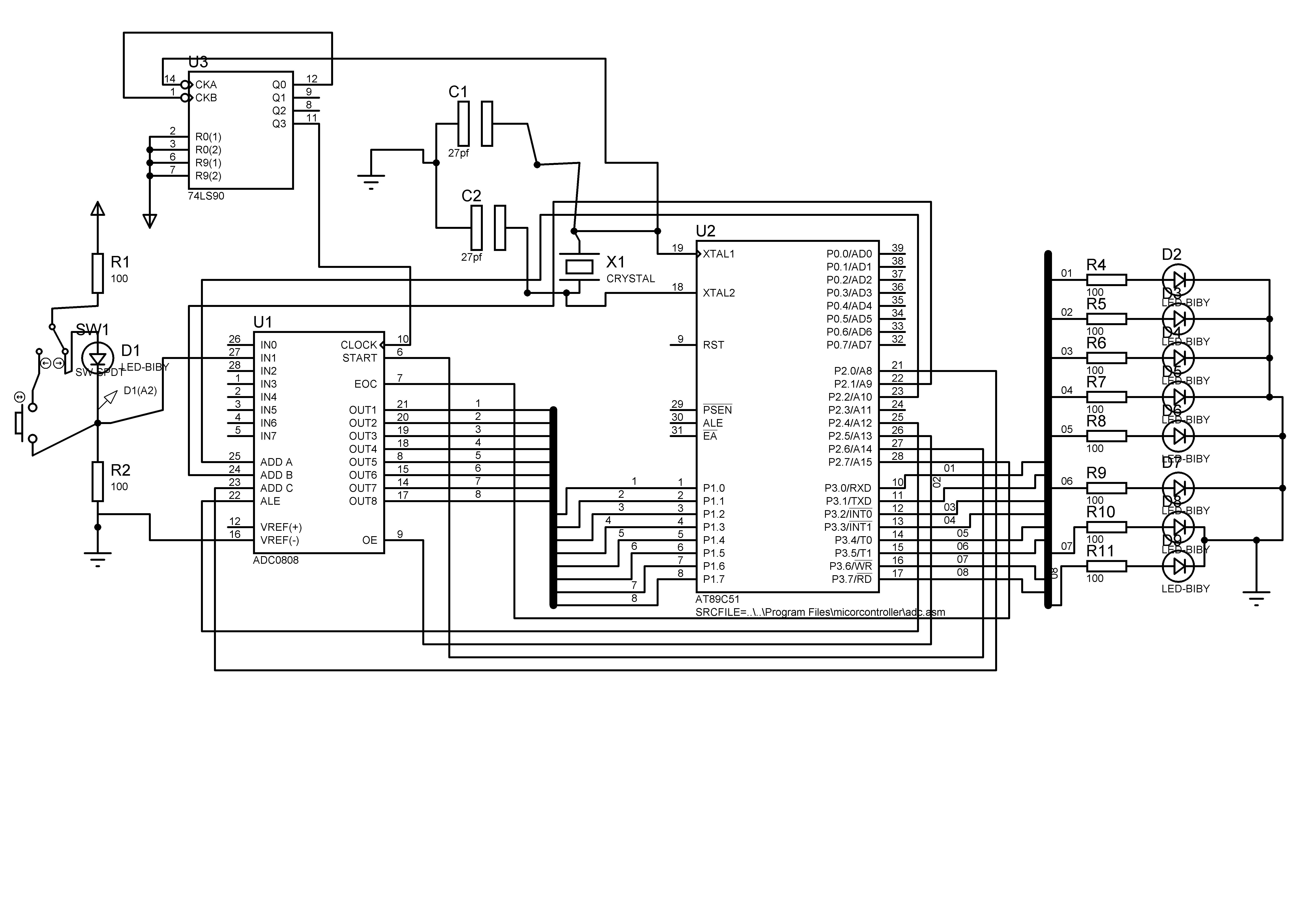

I am interfacing ADC0808 with 8051 microcontroller. I have to give a clock input of 640KHz to the ADC. Is there any way to give the ADC clk through the microcontroller i.e. through the XTAL pins of 8051? Or do we have to give the clock externally? If we have to give externally , then please tell me which circuit to use?
According to national's Datasheet the maximum Clock Frequency is 1.280 MHz.
What is the speed of your 8051 clock.
If more than 1 MHz than you should use some kind of divider !
4040 may do the trick !
Good luck.
STEVE
It is possible to give clock to ADC using any of the I/O pins of 8051. Use its internal Timer to generate interrupt at regular interval and on every interrupt complement the desired port pin. But using software interrupt your requirement of 640kHz clock won't be fulfilled. The frequency will be much lower.
If you are using new generation of 8051s ie. 89Xxx series then you also have an option of using internal CCP module or Timer2 to direcly generate square wave at the output pins of P1. This method can achieve higher output frequencies.

I am testing ADC0808 but ain't getting a proper output. Can u tell me of a proper procedure to check ADC0808? Is the output latched on the outpin pins of the ADC if we connect ALE and OE to Vcc? Or should we check the output at some port of 89C51?
You need to select proper addresses using Address pins and pulse ALE pin to latch it.
OE needs to be raised high when you are reading the converted data.
The following code will read out 8-bit data from the selected channel.

the program yu have return is good but i have a question that i want to read the data from tha adc and i want to send it through rhe tx pin as wella s receive the data form the rx pin and perform the operation from the rx pin and perform the operation. so in this case i dont think giving the clock from the microcontroler to the adc is a good idea.
so is ther any other way to set the clock in auto mode and run the microcontroler for other operations or could it perform the parallel programing?
