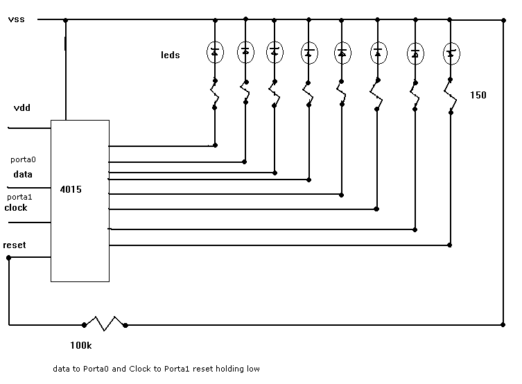

and here is how I have it hooked up. I think I found what I did wrong
I left the part in red out lol should this work thanks for any help
Burt

Ok this is the deal if i send out 0xff it should turn on all 8 leds it just turns on the first 4 all
8 leds will come on if I do it with a switch. And would I not have to reset it before i send new code?
The 4015 is two separate 4 bit shift registers. You need to connect them up separately (2 clock pins, namely #1 and #9) and if you're shifting right make sure you move the "right-hand" one before the "left-hand" one,
1234 5678
move the right one
1234 -567
move the left one
-123 4567
grab the new data
n123 4567
otherwise "4" would overwrite "5" before you had a chance to save it.

The data sheet said you can hook them up with the same clock line. That you feed Q4a to data b and clock a to clock b
I think I'll change chips to 74ls164. the 4015 don't work to good
Interesting. I can't remember whether I tried that when I built a similar circuit, but I've never had any problems when connecting the two clocks separately and clocking them in the right order.
ahydra
What I think is happening is the clock is wrong see when it loads the first data in it doesn't shift it right and when I check the clock line its low that's why ask if I had it right. The clock should be faster then the data like 2 to 1. I no the data is going out right. Some thing is making my clock line low.

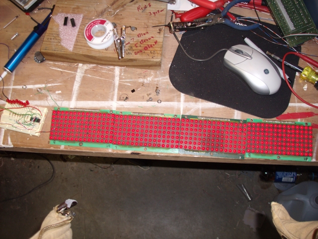

Here is what I'm working on
Well I found why it wasn't sending the clock to the shift register It wasn't going to the Loop Maybe tomorrow I'll get it right thanks for all help
