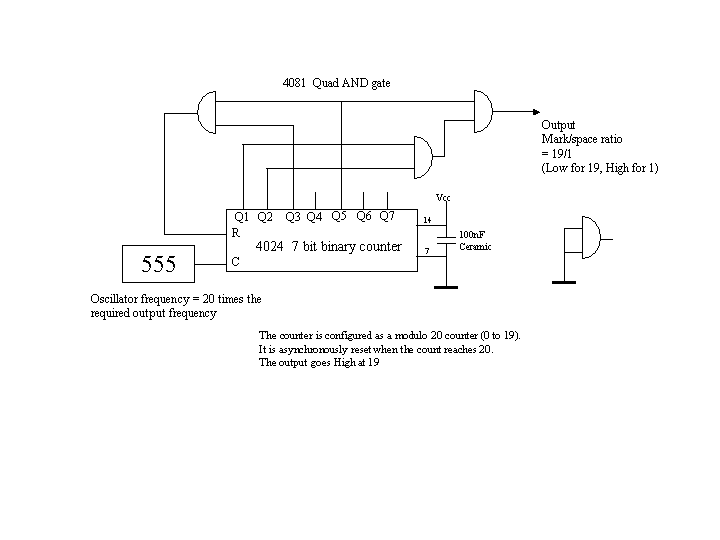

There are 2 ways you can do this.
1. Connect a diode and resistor in series and connect them across the timing resistor. This will make the charge and discharge time constants different, so you should be able to achieve a 5/95 mark/space ratio. This will change the frequency, so you will need to change the timing capacitor in order to correct it.
2. A more elegant and accurate method is to use a modulo 20 counter since 95/5 = 19. See attachment
Len

Generate a 5% duty cycle and run the output through an inverter. Voila! 95% duty cycle.

Duty cycle is normally specified as Tpw(pos)/Tper unless otherwise noted. When you say 90-10, does that mean 90% low and 10% high? I still don't understand what you're trying to do. Write it all out in sentences instead of outline form.
do you need variable PWM duty or do you need fixed 95% duty?
if it is fixed 95% use a 74HC14 (or equive Hex inverting SCHMITT) use cap for the timing to one input then from the output to the input use two resistors in parallel. One of these resistors has a diode in series with it. Get the two resistors right and the cap right and you have 95% duty at yr required frequency

Your requirements are rather hard to follow. Some additional text and some diagrams would assist us to understand.
Len
I don't know if this will really work. It simulates OK, but the 7555 model I have is a behavioral model.
Design the 100Hz, 80%/90% duty cycle oscillator using the two resistor/discharge pin circuit. Design the 40kHz oscillator using the one resistor circuit with feedback from pin 3 to pins 2 and 6 and the cap. Connect the anode of a 1N4148 diode to pin 3 of the 100Hz oscillator and the cathode to pins 2 & 6 of the 40kHz oscillator.
I figured out a way that you might be able to eliminate the diodes, but it would require p-channel mosfets, because the idle state of the 40kHz oscillator was at VCC. I can show you that if you're interested.
