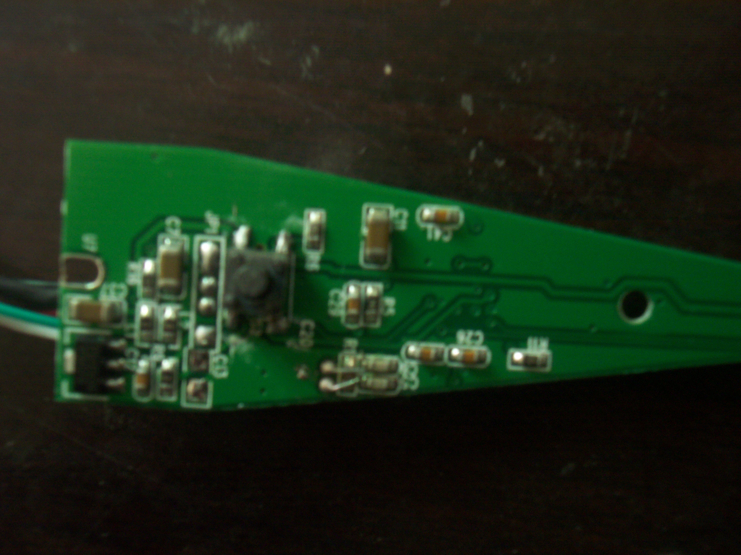

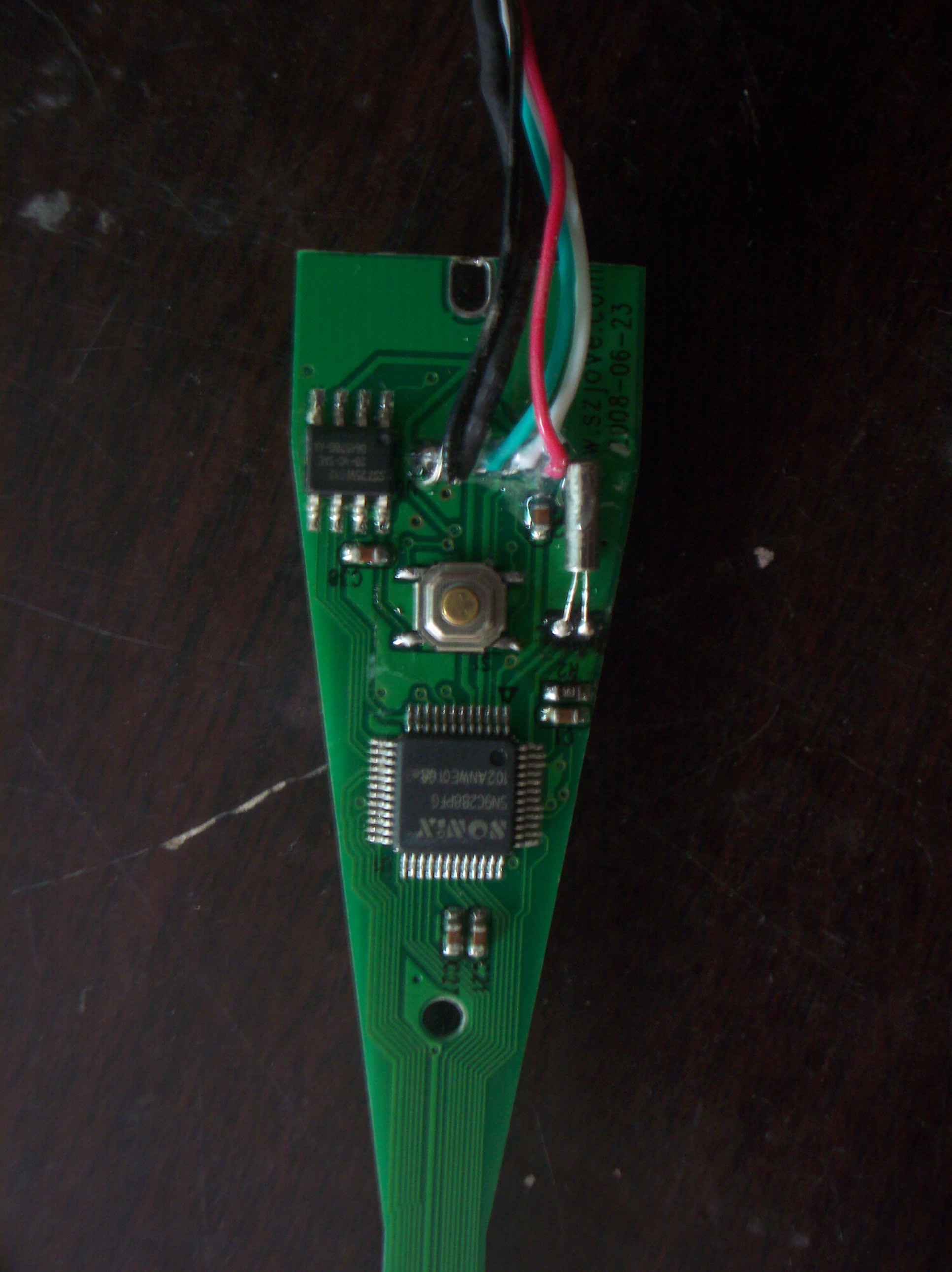

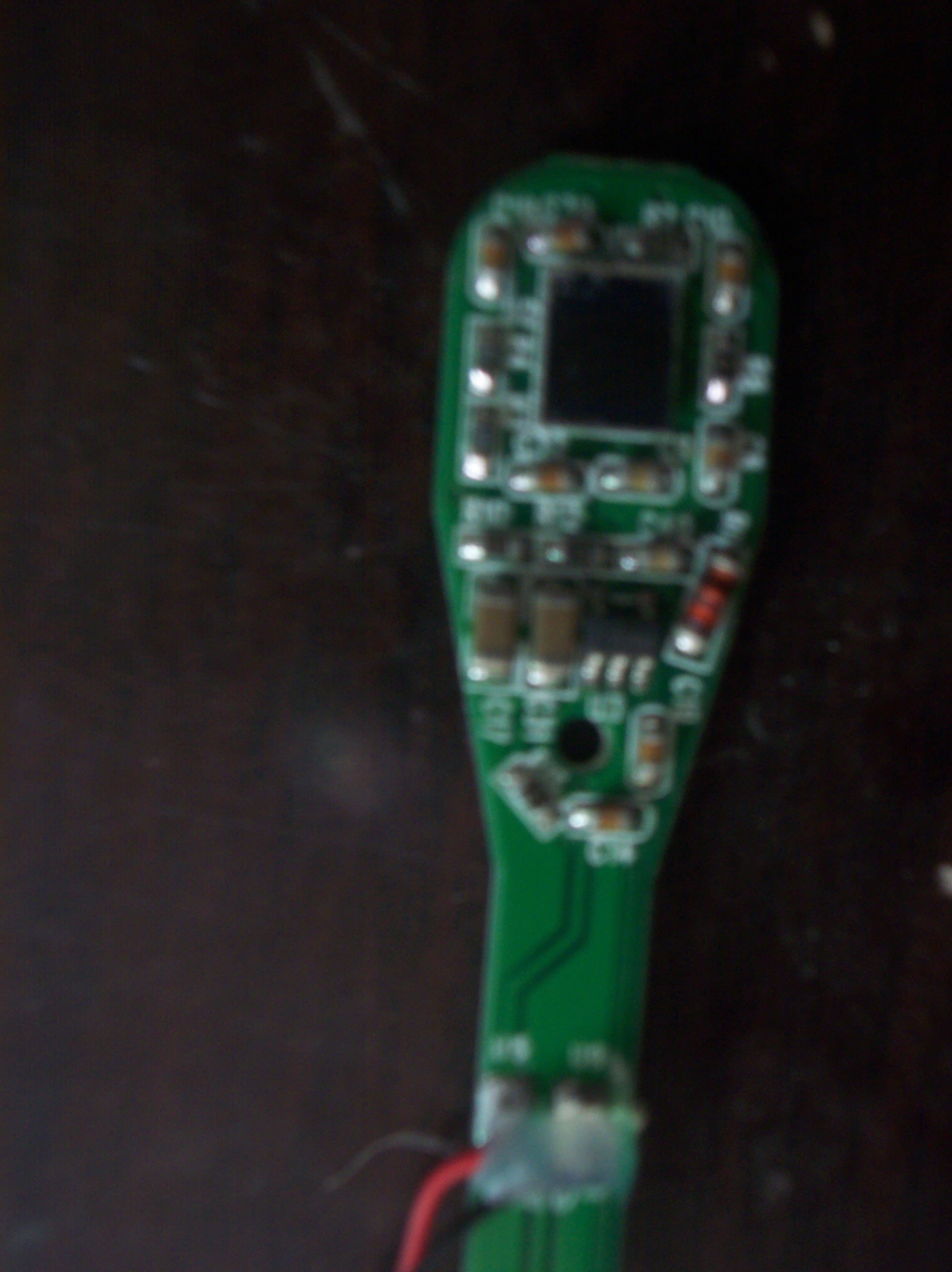

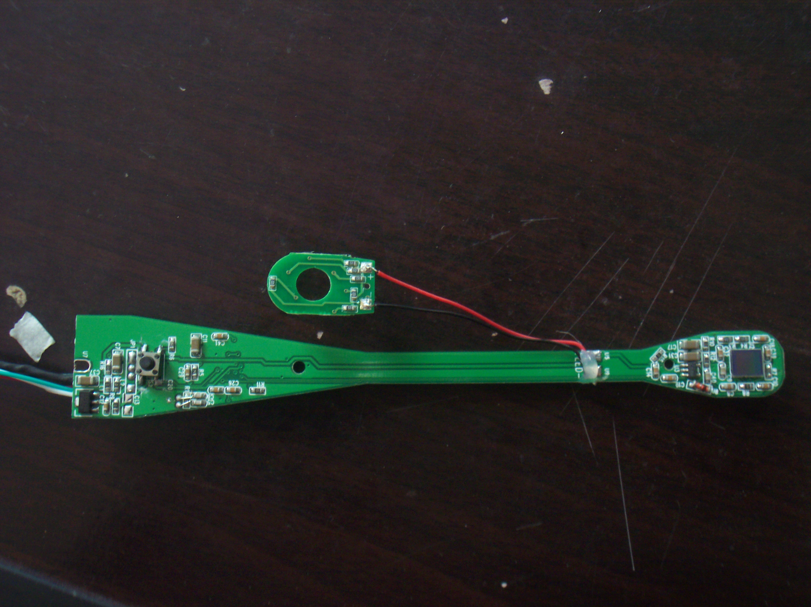

I have attached the picture of a chinese made intraoral camera which can be bought for about 25USD not including the wireless transmission
