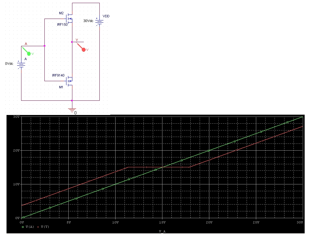

I need to draw Y as function of A:
buffer-jpg.58899
I performed the following simulation.
Is it correct?
non-interting-buffer-jpg.58900
Thanks.

Thanks Brownout!
Did I connected the PMOS and NMOS correctly?
I just want to be sure that I got the source and drain connected properly.
Yes the simulation looks ok but notice the output only goes down as low as about 4v. That's because without a negative input you cant turn the P channel device on hard enough.
Notice also the severe crossover distortion, caused by the threshold voltage.
