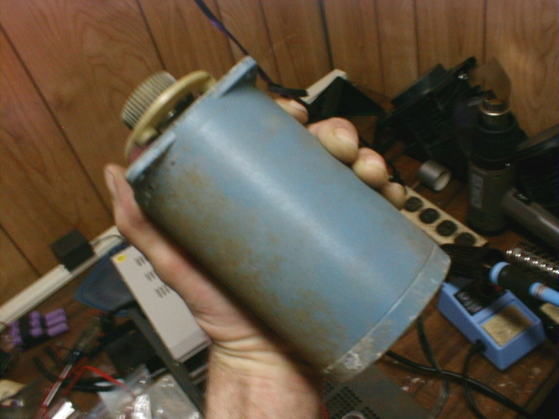

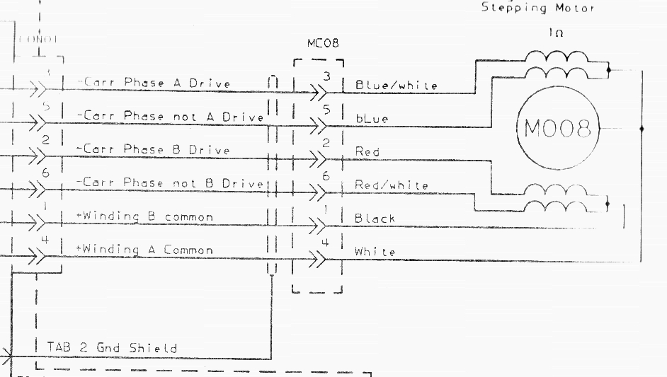

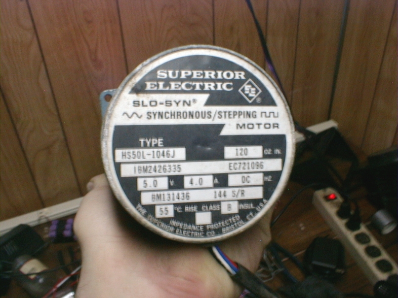

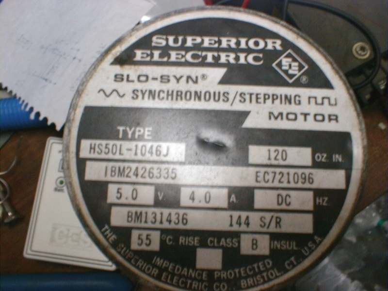

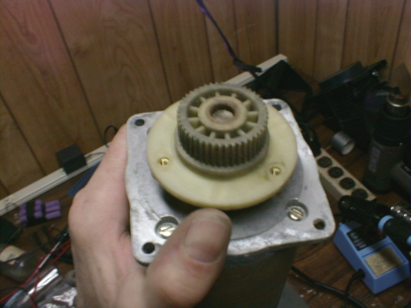

I've got three of these motors, free. They were going to throw away some huge, old IBM printers when they upgraded to laser. Always thought it would be cool to build a CNC router to etch and drill PCBs, but figured these would be a little bigger then needed. I'm more interested in a milling machine. I know my construction skills are much too weak to pull off something that needs to be precise.
