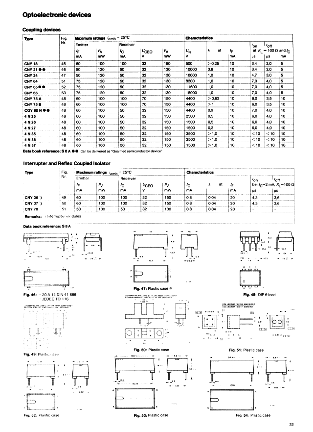

I am looking for a data sheet on a opto coupler
cny 24. Its on a pcb for a thyristor motor controller (elevator 1985).

Hi Ton,
That's an old one, I found some information in the 1980/81 shortform
catalogue from Telefunken. It's not much but it's something.

The file is now in gif format

Thanks all , super support.
Now it possible to repair the thyristor controller.

I took the datasheet and seperated only the info on CNY24
