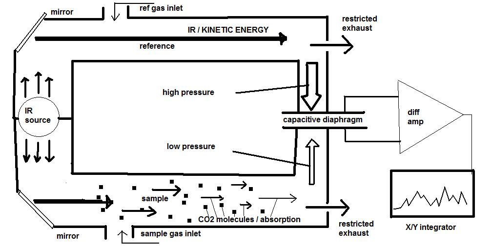

There is a point that the equipment being used, in order to be acceptable as scientific data, would have to be traceable to a calibration standard. This wouldn't be as difficult as it seems, however. The only obstacle is expense (and that is relative). Everything else is easy.
The equipment would have to be NIST traceable. The standard for equipment calibration is typically annual in frequency. Major cities all over the US have calibration shops with NIST traceable references. My company sends equipment to a local company called JW Test Systems. They typically charge $30-200 for a certification depending on the nature of the equipment. A simple CO2 analyzer wouldn't be on the high end. You do realze that CO2 detection can be done with very simple equipment?
The method is NDIR absorption. The equipment is simple, an IR source lamp, an optical path, and a detector...I hapen to work with NDIR equipment made by a Japanese company called Shimadzu. The test method is Total Organic Carbon analysis but the theory is the same.
Two paths of travel for the gases exist, one for the sample, another for the reference gas. The IR beam is introduced at equal intensisty, which can be balanced with reflective mirrors to the detector with the reference gas going through both legs. This is "zero". On the other side is a CAPACITIVE diaphragm or a THERMAL CONDUCTIVITY DETECTOR. The path of travel for both gas tubes will apply the flow equally on both capacitive plates or both resistive elements. When all things are equal, the capacitor or resistors will have a measureable stable signal.
When CO2 is presented to the sampling tube, working against the reference gas, (a pure gas such as helium or nitrogen will work) the absorption rate of the CO2 on the reference side will be different than the absorption rate on the measured side. The more CO2 is present, the more absorption will take place. In the case of a capacitive diaphragm this will cause temperature differential on the plates. A delta T will cause a change in pressure, causing the diaphragm to contract or compress, thus changing the reactance and the signal. In the case of thermal conductivity, a Wheatstone Bridge circuit will measure the change in resistance between the sample and reference legs.
This is a very simple and basic system. There are inexpensive portable detectors with 4-20 mA current loop signals available.
I'm going to post a theory of operation drawing.
IR absorption theory of operation
Here's an illustration that offers the basic concept.
