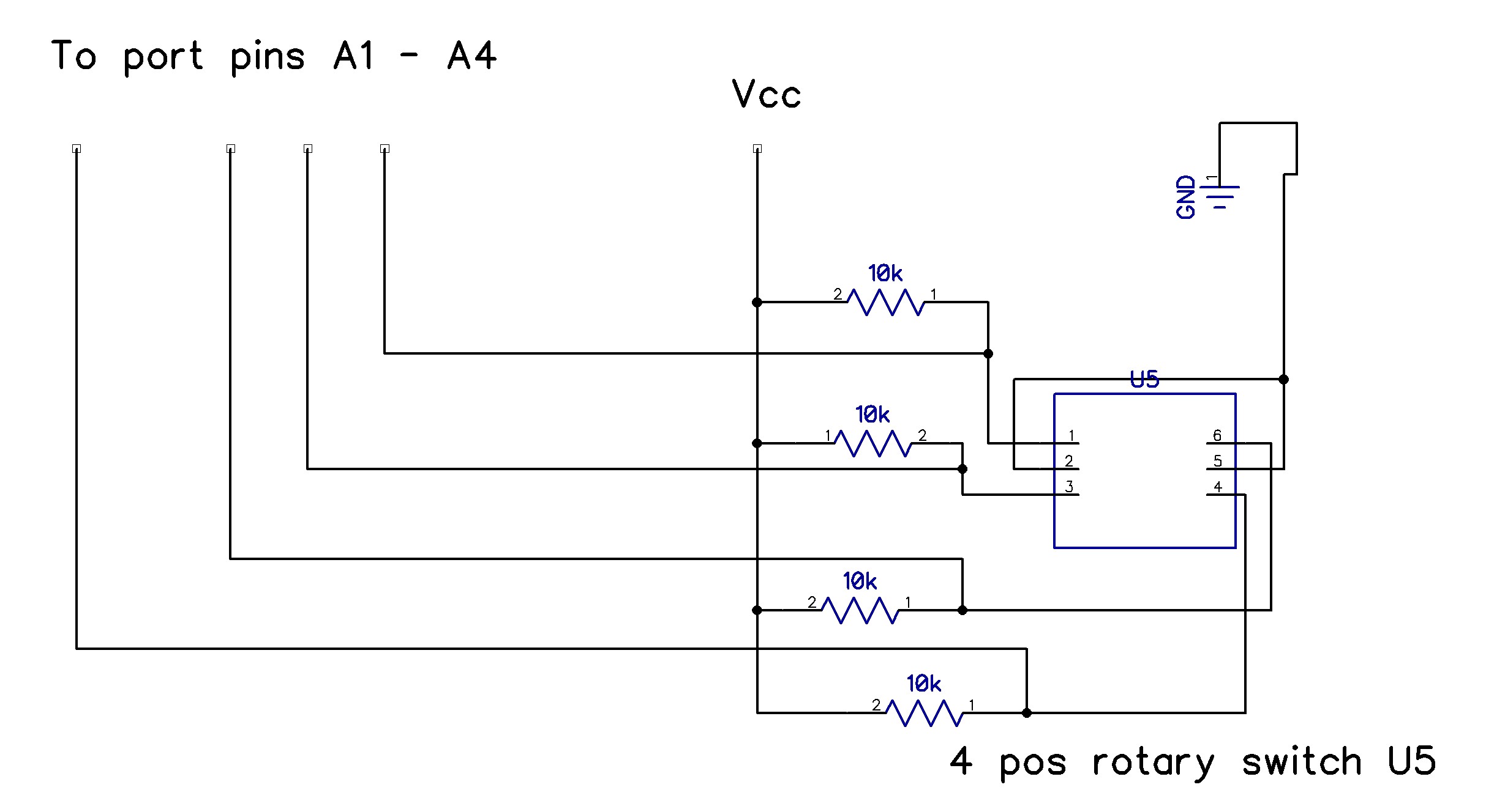

been trying to figure out WHY this code keeps outputting regardless of switch setting.
What it is supposed to do is run only the desired IF THEN statements but it runs all four IF THEN statements. If I have the switch on pos4 (Pg4 = pressed then all three leds light up but the code cycles through all four IF THEN statements.
the rotary switch has the common pin grounded and each position pin is held HIGH
Verified that the correct pic pin is going LOW.
her is the switch, kept looking at switch diagram to be sure I didn't miss anything https://www.mouser.com/ds/2/96/220-786387.pdf
this shouldn't be this hard. I used a working example from my Mexican train game that works but the switches are separate momentary on/off but same code format.

Switches are active low and he probably hasn't turned analogue off.
I have the switches tied to HIGH via 10K pull-ups
Have setalldigital.bas--maybe need additional code?
Need the portA.0 for ADC
have leds connected to port C.5, D6, D7 using to determine state of switch selection.

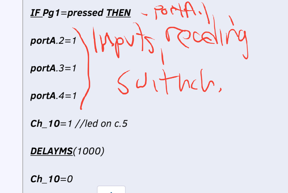

MrDEB, you write interesting code. Completely non-functional but someone could spend hours studying how your mind works.
First, although you have included Utils.bas (which includes the command SetAllDigital) and SetDigitalIO.bas (which also has a command to make all inputs digital), nowhere do I see the command to actually set the inputs to digital. But that is the least of your problems.
You are reading 4 bits of port A to determine the status of the switch (which we still can't understand as you haven't said which part you used) which you have dimensions as Pg1 - Pg4. The 4 bits are inputs.
Looking at the first if/then command, you test if Pg1/PortA.1 = pressed / 0. If it is, then you set the other port A bits high? What is it you think you're doing here? Those bits are the state of the switch pins. What are you trying to accomplish?!?!???
Me thinks you are somewhat confused. How much are you charging this guy for your efforts?

but that didn't work either. Then just out of curiosity I tried using %11111101 t indicate portA.1 as LOW
reason for setting the other port pins HIGH was to make sure they are indeed HIGH

I got something wrong somewhere. Just trying to discover where. I was rechecking the rotary switch and I verified that the port pin inputs are going LOW.
pg1 to pg4 are the switch outputs connected to port pins A1, A2, A3, A4
I removed the rereading of the port pins as indicated in post #8
it is reading the switch but it keeps falling through and executing all 4 IF THEN statements.
It should stop only on the first true if then but it goes through all four regardless of switch setting except the pg4 input
