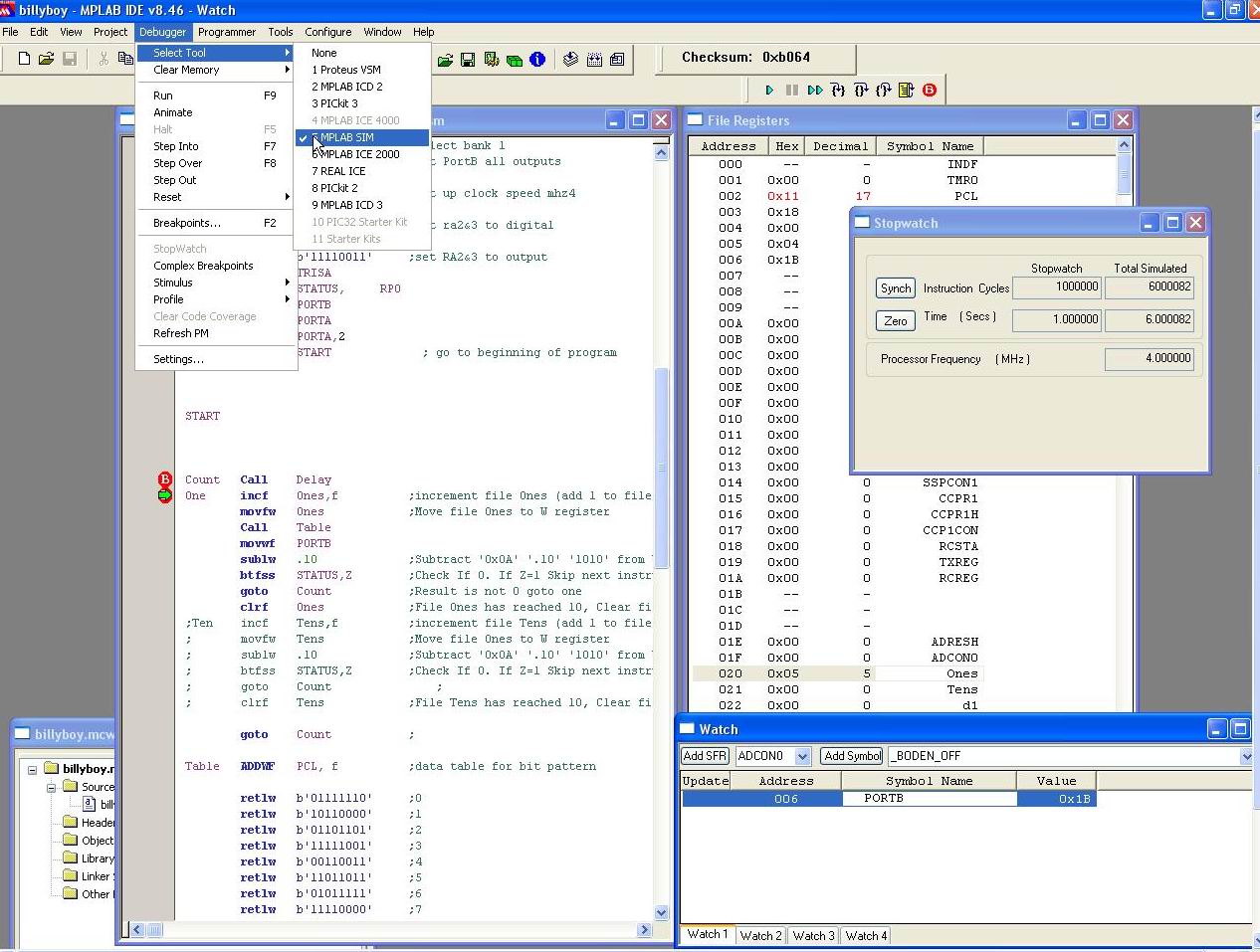

Have run your code in MPLAB Simulator and it runs quiet well up to the point where your logic goes wrong.
Have you learnt to use SIM yet ?
Its worthwhile as you can check your delay times with the stopwatch and watch your code in single step mode while monitoring your Registers.
I can tell you where you have gone wrong but perhaps you first might want to Sim the code and spot the error yourself - its a pure logic error.

You should find out how to use MPLAB Sim in MPLAB Help.
Just build you code, select Debugger, MPlab Sim, then use the Single Step controls in the Debugger drop down - have attached a screen shot of how did it.
It also shows the Stopwatch to check your 1 sec delay.
The Watch window to View the System Registers like PortB
The File Registers to view your User register like ONES
Have a go, its a worthwhile tool to use - shout if you are stuck.

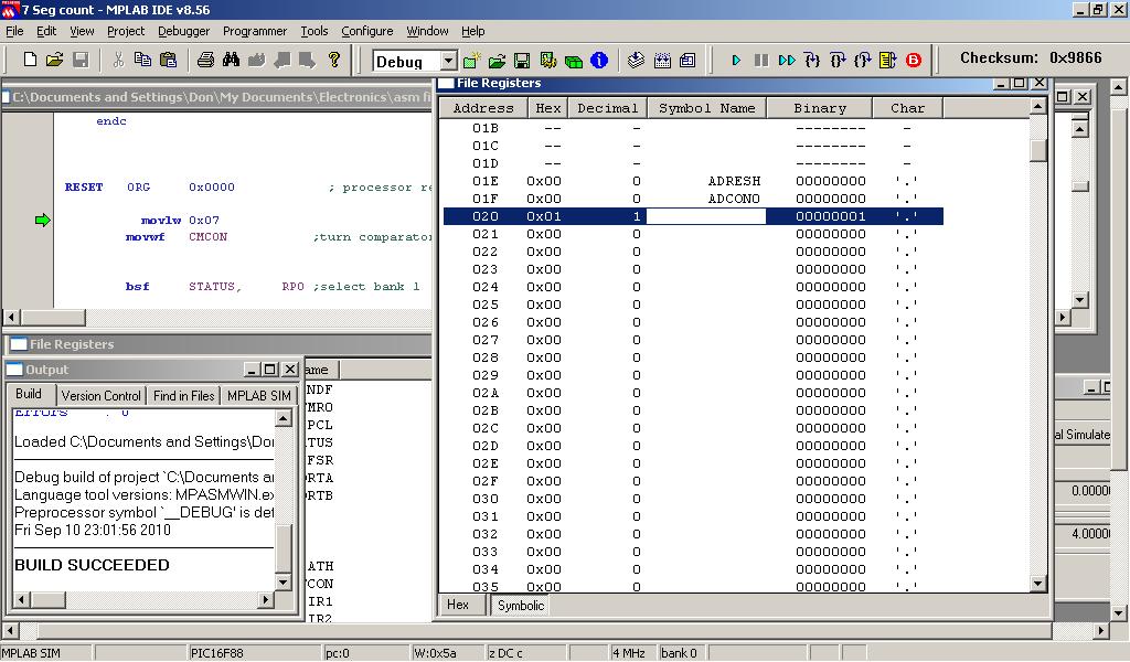

Well I am getting on with MPLAB SIM 8.56 but am stuck with the file registers window. As you can see from the screen shot, I am unable to get the symbol names for my GPR variable registers ones tens d1 etc..
Have you got any Ideas?
I think I have found the problem but pls dont tell me. Just want to get symbol names in file registers window for now.
cheers

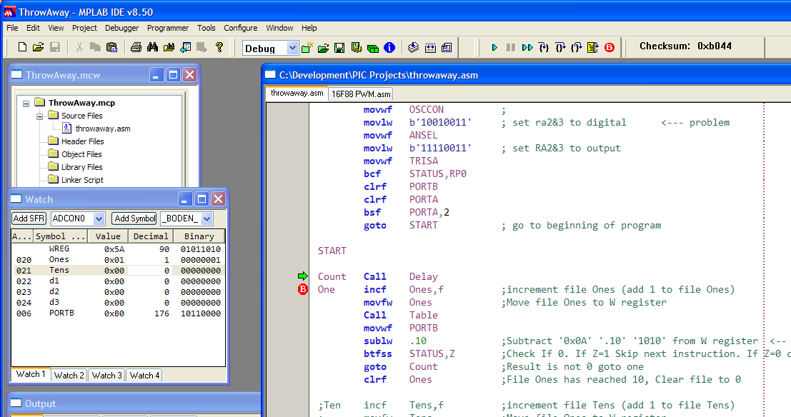

I would use the "watch" window instead...
BTW, I found at least two errors...
Regards, Mike

Just tired to reproduce the same but it still comes up like my original screenshot ( which does not show the answer)
Not to worry about that just for the moment, you can watch PortB count up instead.
Just View, Watch Window, then from the drop down window, showing ADCON0 select PortB instead, then click on the ADD SFR button.
It should now show Portb and its value.
You can then single step, F7, though the code, W is on the bottom toolbar.
However your Call Delay will get you stuck in that loop, so for now just ; the Count Call Delay line out.
As you single step and follow though your loop you will see the logic error occur.

Opps - yes Mike is right you can Add your Ones by means of the Add Symbol in the Watch window
Mike Wp100,
I was just testing the DP to see if it would flash on & off. My problem with the MPLAB SIM and showing my GPRs was due to me building all with a lkr file in the project window. After I removed the lkr file and built again the Add Symbol in the Watch window was no longer greyed out.

Well after a break I found the following problems;:)
movlw 0x07
movwf CMCON ;turn comparators off
This was not inside the bsf bank 1 command.
And this one;
movlw b'11110011'
movwf ANSEL ;set ra2&3 to digital
The value should have been b'10010011 as bits 6 & 5 control RB6 & RB7 :D Doh
I also found some other problems which were to do with the Ones counter, because I incremented the Ones file and then called the lookup table It never displayed a 0, also when the counter got to .10 '1010' I never had any data in the lookup table, so this was then passed to PORTB and lit segments F & D.
So here is my revised code all thanks to the MPLAB SIM
