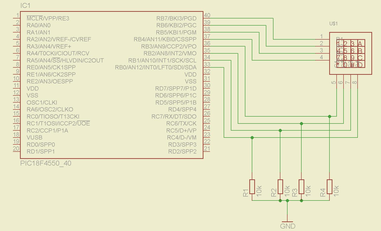

Oops. Just realize your row1 is RB7 and col1 is RB3. Can you show the schematic?
RD7 doesn't go high even you have tried all the buttons?
how to attach image up there?cant attach it..
i use pic18f4550.h and r1-r4 is RB7-RB4 while col1-col4 is RB3-RB0
is my program correct?
i got pull down 10k resistor to ground
but still cannot on the led...
please help me..
so this is my schematic but i just give you the one i just connect the keypad coz' i don't want to draw again my circuit.
do i need to connect 1k resistor at the column?
Hi Darsin,
To read from a matrix keyboard you need to make 1 of the row bits an output and make it high. You can then read 4 column bits.
See if this function will read your keyboard,
unsigned int ReadKeys(){
unsigned int Key;
    TRISB=0b01111111;       //make row 1 output
    LATB=0b10000000;        //and make it high
    Key=PORTB&0x0f;         //read the columns into bits 0-3
    TRISB=0b10111111;       //make row 2 output
    LATB=0b01000000;        //and make it high
    Key|=(PORTB&0x0f)<<4;   //read the columns into bits 4-7
    TRISB=0b11011111;       //make row 3 output
    LATB=0b00100000;        //and make it high
    Key|=(PORTB&0x0f)<<8;   //read the columns into bits 8-11
    TRISB=0b11101111;       //make row 4 output
    LATB=0b00010000;        //and make it high
    Key|=(PORTB&0x0f)<<12;  //read the columns into bits 12-15
    return Key;
When you call the function then it will return an integer with a bit set for each key that is pressed.
HTH.
yes it could work already thanks!
and it is for just row4 (*,0,#,D) on at pin B3-B0 respectively
