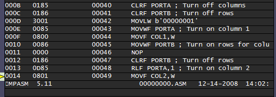

I am using the following code to multiplex a 7x8 LED array. PORTA (0x05) controls which column is on and PORTB (0x06) controls the rows for each column using the values in COL1 - COL8. PORTB changes exactly as it should to show the patterns, however PORTA remains on b'00000000'. I have also tried to us BSF and BCF to turn on individual bits in PORTA but that doesn't work either.

Ran it in my SIM. only time PORTA is called [COL] is COL1.
It would appear the MULTIPLEX code for PORTA is all screwed up.
I'll look thru it.
EDIT: Look at this
MULTIPLEX
    CLRF PORTA ; Turn off columns
    CLRF PORTB ; Turn off rows
    MOVLW b'00000001'
    MOVWF PORTA ; Turn on column 1,
   [B] MOVF COL1,W;load COL1 into W, BUT [COL1] is empty.!
[/B]
EDIT2:
The rotate is clearing PORTA. see image

Let me guess. It's the disabling of analog comparators?
movlw 0x07
movwf CMCON ;turn comparators off (make it like a 16F84)
From Nigels excellent tutorials: "Lines 5 and 6 are specific to the 16F628, 'movlw 0x07' means 'MOVe the Literal value 7 into the W register', the W register is the main working register, 'movwf CMCON' means 'MOV the value in W to File CMCON', CMCON is a register in the 16F628 that is used to select the operation of the comparator hardware. So these two lines set CMCON to 7, this disables the comparator, and makes their I/O lines available for general use."
Don't know the adress of CMCON, but I think that issue has been highlighted earlier...
Good guess by me then (on two posts above) :p
