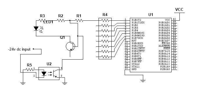

Good day! I am new to microcontrollers and to programming in general, I was wondering if someone could help me with my project.
I am trying to make an LED turn on and transmit the data to another AT89S52 using a MAX485.
I am planning to make Port 1, Port 0 and Port 2.0-2.3 and Port 3.5 as the input and make the LED turn on by connecting the common on the input.
I hope someone can help me. I've attached an example of an input circuit to AT89S52.
Thank you!!

Your schematic looks like a isolated detection for a -24V signal.
An RS485 connection looks like this .
Normally there is no isolation between the bus subscribers.
You can use isolated RS485 Transceivers or use a own circuit to do this.

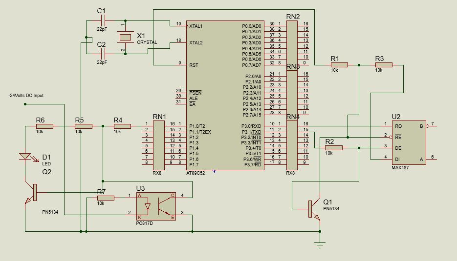

Thank you, I have put a MAX485 on the circuit although the one shown in the diagram is a MAX487 (since I can't find a library for a max485 component on proteus). Since I am a beginner at programming, although I know some basic C and assembly from the books, I can't figure out how to transfer data from ports serially to other microcontrollers. If my circuit is correct, is there any example codes on how to do it on C or on Assembly. Thank you so much for your response.

Just connect TXD to DI, RXD to RO, /RE to ground and another output pin on the MCU to DE.
Normally leave that control output low.
The default state is then that the signal from the balanced line bus is passed to the receive input of the MCU UART.
To transmit, wait for at least one character period with nothing received then set the control output high to enable the driver.
Send the data as a continuous burst, then set the control output low again.
You should get exactly the same data back in to the receiver, as you send it. If it does not match, possibly another device tried to send at the same time.
For simplicity in the software side, you should also add resistors to the bus to bias it so the RXD inputs are normally held high when the system is idle, so they do not get any false "start" bits.
eg. this is a typical bias & termination setup:
You only need the resistor network at one point if the cabling is not particularly long, or add it at the two extreme ends of the cable for long bus systems.
I've added resistors on the bus to bias of MAX485. The LED Turns on even without the microcontroller, and turns off when I put the -24 volts DC supply. I think that's what it's supposed to do, can you help me begin with the codes? I really don't know where to start on coding when it comes to UART or USART, or should I use embedded C or assembly? I've searched examples and codes all over the internet, but still can't find one or can't help me with this project. Thank you!

I am receiving a 5V in the port 1.0 of the microcontroller as well.
How can I put this into a code:
1.) Make the ports in at89s52 inputs while making the LED turn on whenever the -24 volts is received
2.)Make the data in ports be sent to SBUF for transmission to other microcontrollers.
3.)How can I make the other microcontrollers read it so they can show output the same as the transmitter's LED (e.g port 1.1 turns on, port 1.1 on receiver turns on as well)
I am really sorry for the troubles, I am really new at this and needed it to be done.
Thank you so much for you help!

So when someone asked me if I could fix this board, with the same schematics i've given, I said I'll try and take a look at it.
At first the transistor is burnt so I fixed it, thought that'll fix the board but it seems that the microcontroller's program has been corrupted so I tried to study programming microcontroller and I've been searching through the internet and reference books from my college days but to no avail thus I've been taken here when I searched "forums for microcontrollers".
So that's my story, sorry if it looks like I'm not working enough.
Thank you, everyone for the help though.
