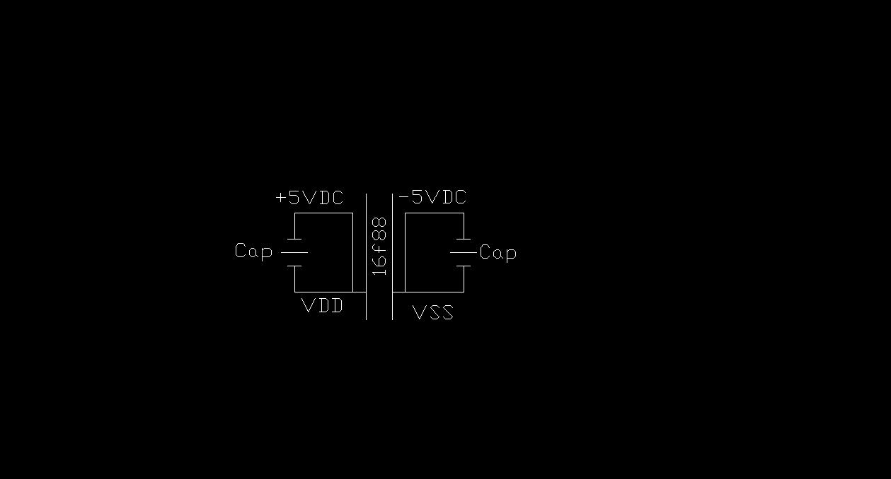

Thanks for your reply Pommie.
The code I posted will compile and run (a little while). I would like for someone to run the code. I will edit and repost if it must be done. I got advise from another forum to add caps at VSS and VDD. I added these caps with no results. I might have installed them wrong. I am attaching a sketch to show their insstallation. Any help will be appreciated.

"simple" code, eh?
your diagram is completely meaningless, by the way. you don't apply -5V to a PIC. maybe you meant the - ternminal of a battery?

philba,
I am sorry my diagram was completely meaningless to you. I don't know much about electronics. I was only trying to show a cap connected in parallel to both the positive and negative sides of the power supply. If I am using the wrong terms again please excuse my political incorrectness I don't know any better.
I would like to get back to my problem now. Something is resetting the PIC. The Watchdog timer is disable. I don't think it has to do with the power supply because the transition to zero's on the display is too smooth and I have run other applications without problems. I think there is a timer or some setting that I don't know about causing the problem. This device seems to have many more registers that can be set than the 84 or the 628 as partly evidenced by the 2 Config statements.
Again, any help will be appreciated.
no political correctness involved - schematics should be clear and show connections. I'd spend a bit of time studying how other schematics are done and try to follow what they do.
It is possible it is your code but frankly, there was so much and it is unformated, it's not worth dredging through.
I would suggest you verify your hardware first. Get an LED with a 470 ohm resistor. Connect it to PortB.0 (resistor to LED, LED to gnd) and try blinking it with a 1 second period. If the blinking is steady, then your hardware is probably OK.
