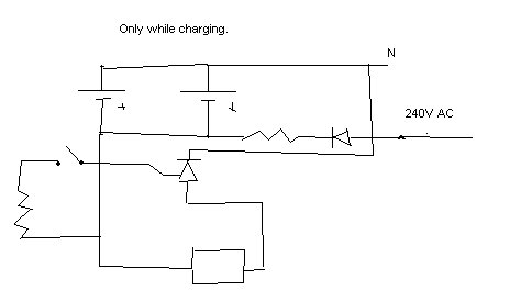

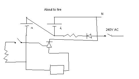

I have found a problem, I have a "leak" somewhere. When i put the capacitors in series (after they are charged) to gain 480V they are discharging quite rapidly. So i have to switch over and fire pretty fast. The SRCs start getting hot as soon as i switch over. They are rated at 800V so i don't see a problem.
Perhaps you could post a rough schem of what your setup is?
As for caps, I'm by no means a 'seasoned' coilgun maker, I just used to mess about when I was younger...but I found photoflash caps were great. 330v 100-800uF and remember, the energy stored in a cap is E = 1/2 C (V^2). Obviously a 1uf isn't going to do much, but plug some values into that equation to workout the best cap.
Without a diagram, I can't say where the 'leak' is....of course caps do lose some energy, but not very quickly, you must have a diode in series with the charger, otherwise they'll discharge back through the charger (not good) but I'm sure you know that anyway.
Unless you have something across the caps leaking current, i don't see what the problem could be. I know everyone uses SCR's for these things, but I was always worried about any 'high current' switch, even if the discharge time is in sub miliseconds time...the current peak is huge.

mynameisdan said:
Putting capacitors in series is unsafe, but i have no choice since my supplier only stocks capacitors up to 450V at 1uF so they're no good.
No, it's perfectly safe if you do it correctly, you should use balancing resistors to ensure the voltage is spread evenly - many PC power supplies use this technique, with two capacitors in series for 230V, and wired as a doubler for 110V.
