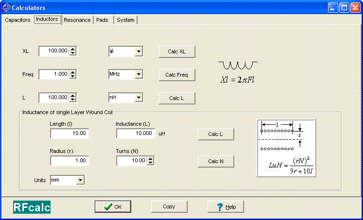

Is there a chart available that tells "how many turns" of "what type & size wire" to make a specific uH coil?
Thanks :D

The RFCal is great.
