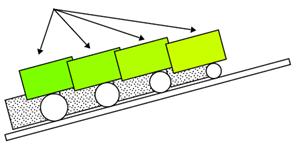

Hey all,
Thanks for all your replies.
Boncuk: You said look at vending machines. I saw this video online where they exposed the inside of a vending machine on this website but i am not sure if i can reproduce the magnetic fields and LED timing to sense what coin it is.
Everyone else: Nearly everyone has stated that i should use a microcontroller in my circuit. Do you mind elaborating on this? What i mean is that how i would go about it? How would i do the calculations proposed etc?
Also, a lot of people have said that i should use different sized holes.
The attachment below is what i plan to do.
Thanks for your help!!

Sensing drops through different sized holes seems easy.
For fun later on, add some area with a variable reluctance transducer or be able to experiment with a magnet and a hall effect transducer to reject magnetic coins. That would just be for giggles. Even an electromagnet to detect magnetic coins. Or you can just ignore it.
Oh' I think I see the problem now (if µ controller is ruled out).
There is a couple of way to do this. First method I can think of is to use two simple registers (a row of d-flopflops) and a binary adder circuit. Thats just an inea, I haven't taught about how to connect them, but there sure is possible to get it done.
Second, size of the coins may pass several sensors so that the number of sencors that responds for a single coins is the same as number of pulses to counter will be. This solution I think is least realistic. It may not work as I think, but then I'm not very familiar with punds coins.
I see using a sensor for each coin. Detect the drop through the single hole.
Of, course the coins have to go through the smallest to largest size. The ramp must be steep enough no to let the coins get stuck.

Its not coin detection thats the problem, the OP has a working slot system, its the counting of the value of the UK coins in pence and the need to manually control the counters U/D for all the 4 decades.
Expanding on what Eric said...
I have got the slots and sensors working.
My problem is that actual detection of what coin is what, and how to add these digits to the 7 segment displays.
Can you help me on this??
