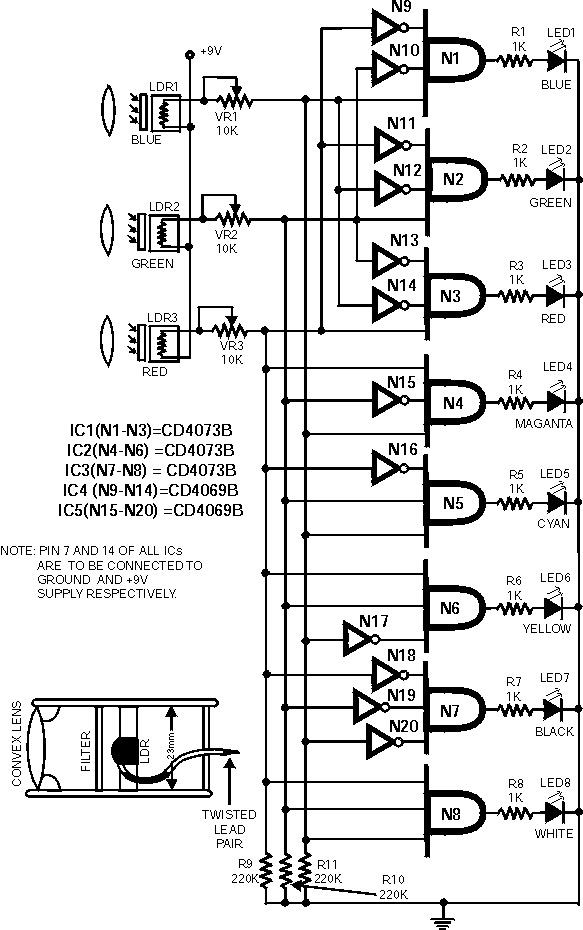

i'm b.tech student.doing project color detector.can any one give me details of the type of filters that i hav to use in color detector circuit.u can find the circuit attached to dis.
please please help me.............

It looks like this circuit uses optical filters of different colours. They are probably cut out of theater gels
Color gel - Wikipedia, the free encyclopedia
These are just coloured sheets of clear plastic.
from a source like this one:
but you may also be able to find something in the hobby section at Walmart or Michaels, but I'm just guessing. Since you would need only a tiny piece of each colour to place in front of your detectors, perhaps its time to scrounge a bit to see what you can find.

Edmund Scientific used to sell thin color sheets of a very wide range of
colors. I dont know if they still do though.
Hi cnu_m,
you might get some ideas googling for "M&M sorter", a machine sorting M&Ms to their colour.

You could use transparent coloured sweet wrappers for filters
Man, that's a cool project. I wouldn't change it to a micro controller. It's already simple.

i came across "color separation filters" . are they useful to me?

What are colour separation filters, if you posted a link to a site where you can buy them, then we might be able to advise you.
"color separation filters" are dichroic (reflective) thingies that are made using thin-film metal deposition on glass.
CSF are superior to theatrical and gel filters in terms of accuracy and stability, but as I understand it, this project doesn't need accuracy.
Typically RGB, CSF's are used to isolate out narrow bands of spectrum. I think they're also used in LCD monitors, but I might be wrong here.
In tri-color separation photography for dye-transfer printing, they use Wratten #25 (red), #58 (green) and #47 (blue) filters. These might well be the ones suitable for this project.
For the techy part of the project, the colours form three points of a triangle within the CIE chromaticity thingy below. Colours outside of the triangle are un-resolvable.
You can use a PC and its colour monitor to test the instrument with, just create the colours by entering the RGB values in something like PaintShop or Adobe watsitcalled.
