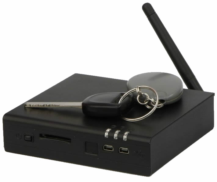

If you use a small embedded PC like a FITPC (see photo) and the FlowStone DSP programming language most of it is done for you!
Heres a colour detect project written in FlowStone (This can be opened in FlowStone FREE). Using FlowStone you can make your own EXE file!
