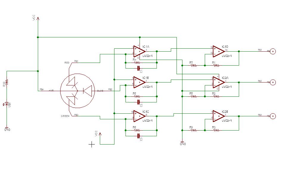

i am doing a project on colour sensor. the attachment is a schematic of my project but the output is unstable and i cant figure out how to stabilize it... need help... urgent..

Not sure, but I believe you are using an LM324. I would suggest something better with a +/- supply voltage.
Take care.........Gary
If the op amps are LM324, the common mode range does not include the positive supply. You have the noninverting inputs connected to VCC, which is outside the common mode range. With the other end of your photodiodes also connected to VCC, their capacitance will be higher than if you had them reverse biased. High capacitance on the inverting input can lead to op amp instability (when you get your op amps biased correctly).
