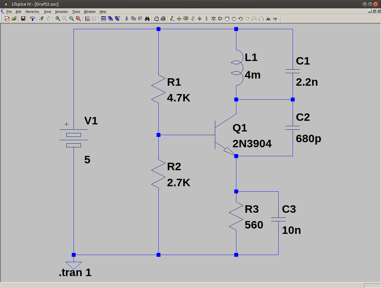

yes i changed to 4.7kOhm with 5% tolerance but still no output waveform.R2 shows at 4.7 ohms, not 4.7K ohms ?
Regards, Dana.
i have all components tolerance set to 5% even the 4.7KOhm(which is incorrectly 4.7Ohm, corrected it) and still there is no output. I have done many oscillator simulation and all have so far worked but not this one.I have not examined your circuit in detail, but this is not uncommon when simulating oscillators with ideal components. Usually they require something to "kickstart" the process like an initial condition, a noise source, or parasitic elements. It seems like some circuits want to oscillate and others require more encouragement.
That's a rather dodgy circuit.i am trying to simulate the colpitts oscillator circuit as shown
the resistance of the inductor is not set, but i used the same inductor for many oscillator and they worked. i also added small resistance in series to the inductor but the circuit is not oscillating.Whats the resistance on the inductor?
yes, this is the form of Colpitts oscillator I know, but the one I showed should also work, isn't it? I have seem them in FM transmitter circuit and was wondering whether this is actually the oscillator or not.That's a rather dodgy circuit.
It should definitely have a decoupling cap from base to ground, and, strictly, a cap across the emitter resistor to fit the definition of a Colpitts circuit: Feedback via a capacitive divider.
eg. This is the fundamental config for a common base Colpitts:

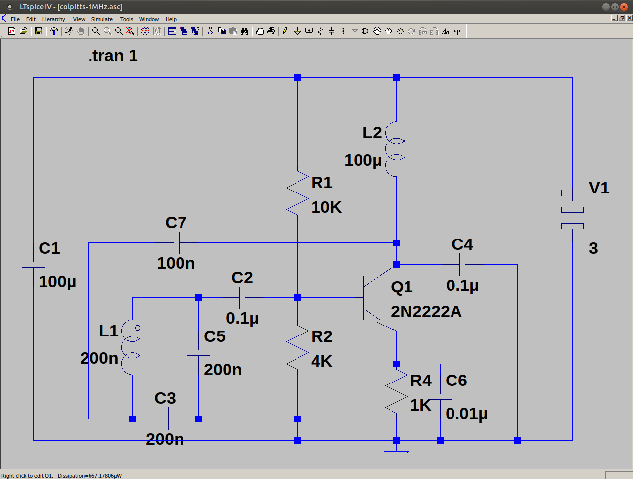

thank you, but i want to know whether the circuit i posted works or notIf you want a 1MHz osc may I suggest this one:
At the very least you've left out the capacitor decoupling the base.yes, this is the form of Colpitts oscillator I know, but the one I showed should also work, isn't it? I have seem them in FM transmitter circuit and was wondering whether this is actually the oscillator or not.
i tried the decoupling capacitor at the base but does not work, used various values, is the circuit i posted an oscillator at all?At the very least you've left out the capacitor decoupling the base.
yes, this works. thank you. but the resonant frequency should be near 100KHz but it is showing 44.7KHz.Here try this:
Yes, I calculated it has 110KHz, but yes it's only 44KHz, I don't know the reason for the discrepancy.yes, this works. thank you. but the resonant frequency should be near 100KHz but it is showing 44.7KHz.
resonance frequency with 4.88mH and 2.2nF is 48.60 KHz so does that mean the capacitor 680pF(C1) has no effect?so that means this is not a Colpitts oscillator. what is the function of the capacitor between collector and emitter lik the capacitor C3 we see in many one transistor FM circuits shown below?4mH with 2.2nF should be resonant at 53.65 KHz. That does not allow for the other circuit capacitance.
