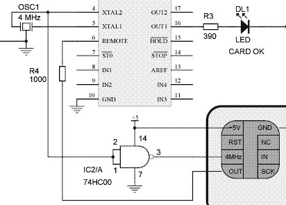

The crystal problem with the smartcard is now just like you said.
The mod i did was, i now use as clock source the same chip.
with a 4mhz external OSC.
Sow the impedance and every other param are more the same..
and the chips will be exactly doing the same.

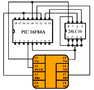

So this is for communication between a PIC and a smartcard (which contains a PIC)?.
Why have you only got one pin available for the communication?, smartcards give at least three - MCLR, and the data and clock pins so that you can program it.
SmartCards
Have MCLR,Clock,Data pin..
(and VDD, VSS)
Clock you will need to startup the device in that matter that it works..and processes your programm.
MCLR you will need to put it high sow it starts processing to.(reset pin)..
And Data Pin is then the only one wich is free available for communication / verication purposes....
Because of the fact that it would be very insecure to not make it 2way comm. You will need to switch input / ouput many times.

You're missing a pin that has to be there!.
Assuming it's a PIC on the smartcard?.
To program the PIC it requires:
Vdd
Vss
MCLR
RB6 (programming clock)
RB7 (programming data)
For the smartcard to run a program it require:
Vdd
Vss
MCLR
Oscillator input (pin 16 on a 16x84)
This gives a total of six connections to the PIC on the card, two of which (RB6 and RB7) are general purpose I/O pins.
Are you perhaps confusing the programming clock input with the main oscillator input?.
ahhhh
sorry to mention!!!
but the RB6 is internally connected to the clock line.
So while programming you use the clock line for the RB6 pin..
while normally use you just use clock..
sow only RB7 is there for the outside world.
I was lucky that i had some PCB smartcards with the same pics sow i just made an serial debugpin on them..
etc..
Sow i could test with an unlimitted pic...and in real life i just use the wafer edition.

Clock Source!!
use same pic model for best performance..
