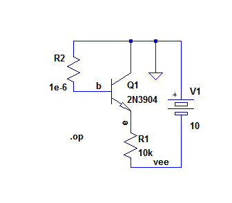

Here is a simple simulation, with the DC operating point calculated. I put GND on the collector for simplicity.
Here is the operating point:
       --- Operating Point ---
V(b):	 -3.11236e-012	 voltage
V(e):	 -0.6535	 voltage
V(vee):	 -10	 voltage
Ic(Q1):	 0.000931538	 device_current
Ib(Q1):	 3.11236e-006	 device_current
Ie(Q1):	 -0.00093465	 device_current
I(R2):	 3.11236e-006	 device_current
I(R1):	 0.00093465	 device_current
I(V1):	 -0.00093465	 device_current
