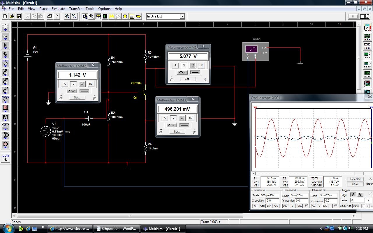

Hello,
I'm working on a common emitter amp and need some help with the attached circuit.
I want to understand how this thing really works and it doesn't seem to be doing what I think it should. I'm using multisim to simulate so don't know if multisim is causing some issues.
First wouldn't the base voltage for the base of the transistor be something like 5V because of the voltage divider? multisim is reading 2.1V.
Also wouldn't the Ic be 1mA. Multisim is reading 850mA.

You bias is not good. R1, R2 wants to pull the base to 5 volts. This should pull the emitter to 5 volts. The gain is set to 10, so the voltage across the collector resistor should go to 50 volts.

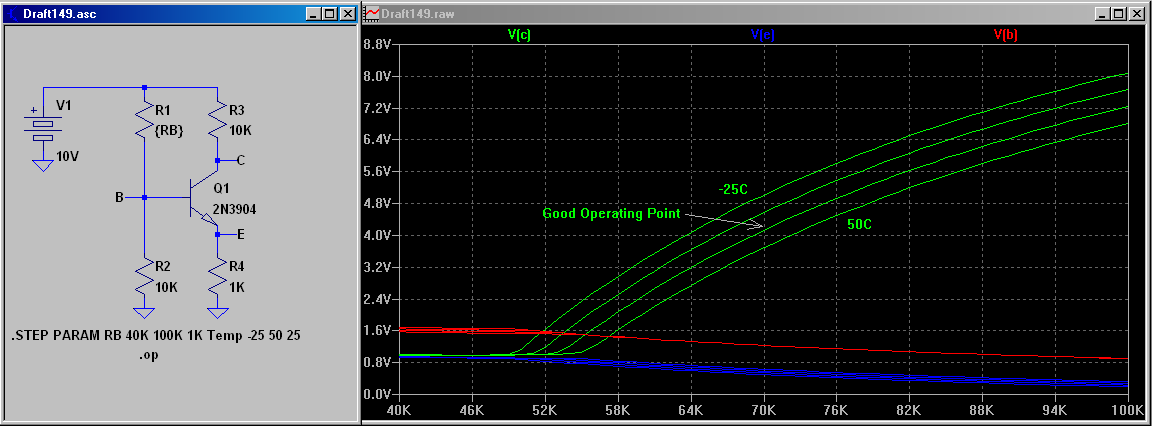

You need to change R1, R2. Set the base voltage to about 1.1 volts. The goal is to set C=5 volts, E=0.5 volts, and base to 0.5 + 0.6 volts.
Assuming that you think that R2, R3, and R4 should be the values that you have chosen (not the best values, but they will do for now), you would like to choose a value for R1 that biases the collector about halfway between the emitter voltage V(E) and the supply voltage (10V). I used LTSpice as a calculator which plots V(c), V(b), and V(e) as a function of R1. It is also good to check to see what would happen as a function of temperature, too.
Note how LTSpice lets you do both at the same time...
Note that R1=~70K would be good bias point.

Well with the circuit I have posted I need to calculate the base voltage, output voltage, base current, and collector current.
I have made measurement in the lab and got Vc = 1.475, Ic = 0.846mA, Vb = 2.14V, Ib = 0.798mA
Do you see that your transistor is saturated? Then it cannot amplify its input signal.

Look at the plots I posted. If you extrapolate backwards making R1 less than 40K, what do you see happening?
The '3904 is saturated, and cannot be used as an amplifier. The entire goal of a "bias circuit" is to put the transistor into a condition where its collector is resting at a voltage where the collector can swing both positive and negative, and thus amplify an AC-coupled input. You either missed that point, or chose to ignore it.

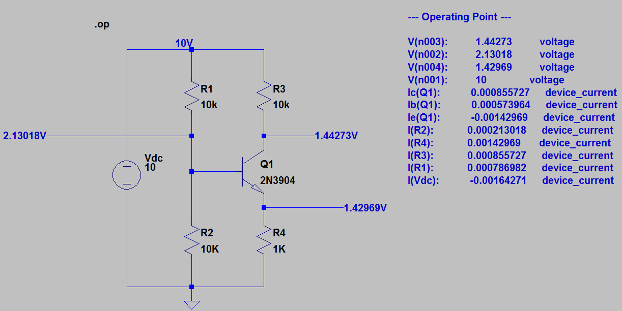

What I'm trying to get from this is how all the numbers are obtained. I have attached another schematic from LTSpice. Let's forget about the input AC voltage for a minute. How does the simulation come with all those numbers? What are the calculations done?
Are you asking "how does LTSpice work"?
When you direct LTSpice to do a "DC Operating Point" solution (.OP directive), it effectively does a solution of a system of several simultaneous equations in several unknowns until it finds a consistent set of node voltages and branch currents that (hopefully) mimic what the real circuit would do.

What's in bold is what I'm really looking for. I'm trying to find the numbers manually using algebra and with the components given in the circuit (say we didn't have computer).
I built the circuit on a breadboard and the results were pretty close to LTSpice.
With the 10k collector resistor, the 1k emitter resistor and a transistor that saturates with its collector to emitter voltage 0.2V then the saturated current is (10V - 0.2V)/(10k + 1k)= x. The saturated voltage at the collector is 10V - (x times 10k ohms).
Also the emitter voltage is x times 1k ohms. So the saturated collector voltage is 1.09V.
The collector voltage when the transistor is cutoff is 10.0V. The average voltage is 5.55V which is where the collector can swing equally positive and negative.
So the collector current is 0.45mA at idle and the emitter current is almost the same so the emitter voltage is 0.45V.
The base voltage must be 0.65V higher at 1.1V.
You can calculate the resistor divider to give 1.1V at the base of the transistor. The very small base current will affect the divider a little.

So lets do an analysis on this circuit, EVEN if this was not a simulator, you still breadboard the circuit, and take all the imperical measurements, to come to a logical analysis of the circuit.
So now these are the measurements you have come up with, (data).
From this data you now can analyse its behavior, AND how to design it so as to eliminate these bad characteristics.
Hopefully you have a good understanding of the basic laws (ohms, kirchoffs,ect...)
Lets start out and determine the loading affect the transistor has on the input voltage.
1. without transistor VR2 = 5v. current IR2 = 500uA.
2. VR1 = 5v. @ 500uA.
3. With transistor VR2 = 2.13v. @ 213uA
4. VR1 will then be (VCC - VR2) = 7.87v. @ 787uA.
5. Delta current through R1 goes from 500uA, to 787uA. = 287uA.
6. Delta IR2 goes from 500uA down to 213uA. = 287uA.
7. If the total current is now 787uA through R1 and 213uA OF IT flows through R2
that leaves (787uA - 213uA) = 574uA. left over to flow into the base of the transistor. = (IB)
That shows how the transistor affects the input signal.
Lets carry the analysis further.
Now a measurement across the emitter resistor determines a voltage of ~ 1.43v. = VR4.
That makes the voltae Vbe = to ( 2.13v. - 1.43v.) = 0.7v.
Now with VR4 measured then the emitter current will be (1.43v. / 1K ohms) = 1.43mA.
Now to solve for collector current we take the emitter current and subtract the base current we calculated earlier.
(1.43mA - 574uA) = 856uA.

let's start with: if the B-E junction is forward biased, Vbe is 0.7V.... period. this is probably what is confusing you the most. a transistor junction is a nonlinear resistance. once you get to a threshold where it starts conducting, it's resistance decreases nonlinearly as the current increases, so the voltage across the junction changes very little as the current increases.
Er1=7.87V, Ir1=787uA
Er2=2.13V, Ir2=213uA
Er3=8.56V,Ir3=856uA
Er4=1.43V, Ir4=1430uA
so the B-E current will be the difference between Ir1 and Ir2, or 574uA, which is also the difference between Ir3 (collector current) and Ir4 (emitter current).
the data sheet says that a 3904 has a beta of 70 at an Ic of 1ma (and we're close to that here), so it would take about 14uA to saturate the transistor in this circuit (ballpark figure), so you can see that you're far beyond saturation here.
so, that's about as simple an analysis and explanation of why the transistor is in saturation as i can come up with...... what somebody said above about setting the voltage divider to more like 1V (without the transistor in circuit) will get you in the ballpark of amplifying a signal rather than saturating the transistor... look again at the Ib(sat) (base current required for saturation) i calculated above and keep that in mind when you select resistor values for the voltage divider.
In your 1st circuit it is obvious that the transistor is biased wrongly and is saturated. The emitter resistor value is 1/10th the collector resistor value. We know that the collector voltage should be near half the supply voltage so that the collector voltage can swing equally positive-going and negative-going. The datasheet has a graph that shows the typical base-emitter voltage of 0.65V and we know that the emitter voltage must be 1/10th the collector voltage, about 0.5V. Then we know that the base voltage must be about 1.15V, not 5V.
You can calculate the wrong base voltage because we know the collector and emitter current. The saturated transistor has a collector to emitter voltage of about 0.2V and a supply of 10V. Then the collector and emitter current is (10V - 0.2V)/(10k + 1k)= 0.89mA. The emitter resistor is 1k so the emitter voltage is about 0.89V (but the base current causes the emitter voltage to be a little higher). The base voltage is 0.65V higher at 1.54V, not 5V.

take that 500uA times R4 and that give an emitter voltage of 0.5v.
Add to that Vbe of 0.7v. and that gives 1.2v. at the base.
So again if the voltage divider is suppose to have 5v. at the tap, and your getting a calculated value of 1.2v, then you know that the voltage divider is being upsetted by the base current, and so the design is a no-go, for an amplifier.
The base current should not control the base voltage, but rather the external voltages by the divider should control the base current.
So thes are quick analysis methods to check if a circuit is designed properly.
As I said before to calculate the way the computer does, means a lot more equations and device parameters need to be used.
Hope this helps...
