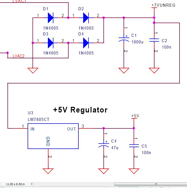

here is the power schematic im using...
the ground (the triangle) im using is whats going to PIN 5 of the SERIAL CONNECTOR that goes to my PC... (USB>SERIAL ADAPTER)...
the TRANSMIT pin of my dongle is going to an input on the MAX233A chip...which is also powered by this same ground...

The power supply looks ok, although I would want at least a 100uF cap on the output of the 5V reg
Post a complete schematic of your project if you can, so that I can see if you have something hooked up incorrectly
If essentially all you have onboard is just a serial port (Max233) and you're using one of those convertor leads, I see no problem with a common ground.

on my PSU i had a 47u and 100n cap AFTER THE regulator on my seperate board...
on my breadboard i had ANOTHER 100n decoupling capacitor that was there when i started... once i remove that cap on the breadboard...the ckt works just how it does in USB power mode...no common ground issues...

I mentioned to you that I would change the 47uF to at least 100uF on the output of the regulator...have you tried that ?
