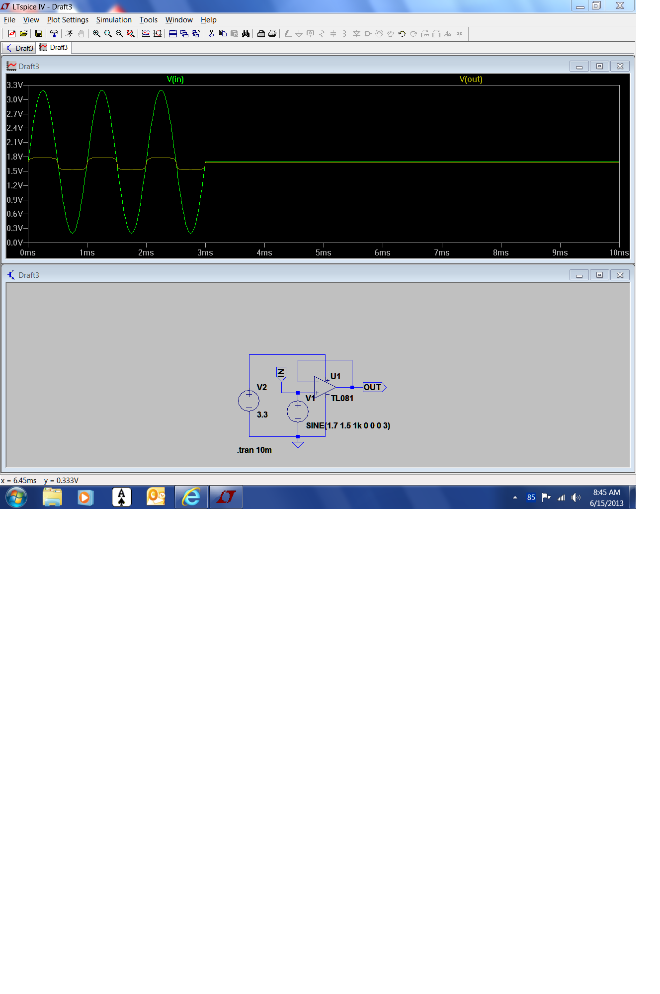

Like I said... The input stage cant work above the common mode range so your output will be Vcc - the common mode voltage. Something like this: Not your op amp, but you get the idea. You need a rail to rail input device.
so will i get latch up to one of the rails , or just clamping of the output to the common mode range limit voltage?

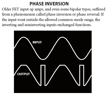

Some opamps have The Opamp Phase Inversion Problem where the output suddenly goes high when an input goes lower than the input negative common mode voltage limit.
