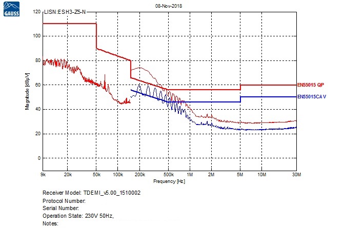

We have two versions of this LED driver which are exactly identical, except for the fact that one has eight separate large COB LEDs, and the other has 100 LEDs on a large (18cm x 24cm) piece of MCPCB. Whether its with COBs or MCPCB, the COBs or MCPCB sit on top of a large aluminium heatsink which is earthed.
We did conducted EMC scans on both COB and MCPCB versions of this product.
The MCPCB version gives a far worse conducted scan than the COB LED version. (as the attached shows). It’s obvious that this is due to noise capacitively coupling out of the large area MCPCB and into the earthed heatsink. Thus the problem is primarily a common mode noise problem. The “problem frequencys” are from 150kHz to 350kHz. This shows that Common mode conducted problems can manifest at low frequencies like 150kHz.
