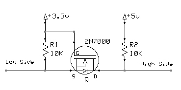

I was also wondering whether the raspberry pi would be able to do both. I think I need to use the I2C capabilities of the RPI. I2C is still new to me, but in my situation it looks like I need to setup a scenario with multiple masters since the panel, keypad and RPI will all initiate communication. If this is possible, I still have the problem with the data signals across the wires being somewhere between 0-12 V. If I attempt communication using optocouplers, this is complicated because it requires two way communication on each wire, so two optocouplers and diodes? for each wire? (is a component for this available?) I also don't understand the drawback of using the house wiring to power both the alarm panel and the RPI. What negative effects might I see because they share a common ground?
The bi directional level conversion is simple. This is the standard circuit to convert between 3.3v and 5V logic it is bi directional and works just as well with 12 volt logic on the high side as it does with 5 volts on the high side. I think your interface eith the alarm just needs to emulate an additional keypad. As you have now mentioned I2C protocol have you now established that is used for communication between the main alarm and the keypads ?

Makes perfect sense. Thanks. I will work on trying to get my hands on the oscilloscope. Does the bi directional level conversion only work in the case of I2C or does it apply to more general signal transfer?

The level converter will work for any protocol. I forgot to answer that question in my last post.
