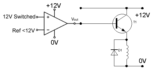

This is what I've got essentially.
untitled-2-copy-jpg.32091
If I were to switch it with ground, I would simply change the circuit to the one you posted but still use the + off of the output of the opamp, correct?

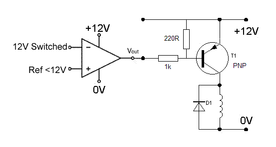

You have it configured as an emitter follower which is fine in some applications but does have the problem of having a large voltage loss.
When the output of the 741 is high, the voltage across the relay with equal 12V - the 741's saturation voltage - the saturation voltage of Tr1 - the base emitter voltage of Tr1. As a rough guess the voltage across the relay will be 12 - 2 - 0.7 - 0.3 = 9V which might not be enough to activate it.
Here's a better way of switching the positive to the relay.
The transistor is now connected in common emitter configuration.
Note that the transistor has been changed to a PNP type and that the input to the op-amp are reversed.
