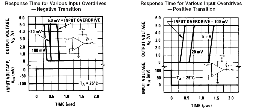

Actually, the LM339 (and most other comparators) gets faster with more overdrive. See the graphs below, which are from the National datasheet.
