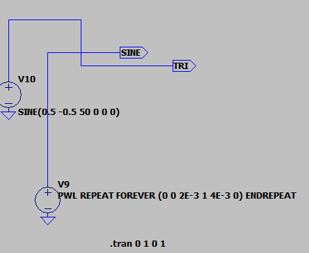

COMPARE THIS TWO SIGNAL TO CREATE SPWM PULSES OUTPUT
HOW TO COMPARE THIS SIGNAL USING RELATION OPERATOR OR USING COMPARATOR COMPARE THIS TWO SIGNALS TO GET OUTPUT OFF SPWM(SINE PULSE WIDTH MODULATION)
enter image description here
PLEASE HELP ME CREATE IT

Your Sine and Tri labels should be swapped.
Try googling "sine wave pwm" to see the standard ways to do this.
....To get sinusoidal PWM....you put the sine into the comparator, along with the repeating ramping wave.
So re-base the sine so its always positive........from 0 to 5V say....that being peak to peak...
Then you shove the ramp into the other comparator input.....ensure that the ramp's peak is slightly higher than the sine's peak.
Obviously the frequency of the ramp should be much much faster than the sines frequency.

sorry for using capitals. i know spwm working i want how to know compare it and also invert the pulses

what comparator to use it?

triangle (ramp) freq must be much greater than sine frequency......say >30kHz.
What comparator?.....Any general purpose comparator will be ok.
(as long as it accepts the voltages you will be using with it)
and also how to invert a output square pulse?
You could use the inverting input of an opamp or comparator. If the pulse voltage is a logic level one then instead you could use a digital inverter.
An LM339/393 is a common comparator that should work for your purposes.
Note that, since the output is an open collector, it requires an output pull-up resistor of a few kohm to the V+ supply for proper operation.
Reversing the two input signals to the comparator will reverse the output signal polarity.
You can also use another comparator to reverse the signal polarity.
here i Have attached the file with sine and triangle(ramp) signal in it.
could you please compare it and invert the output signal. and upload it here please
Could please show short image or drawing representation of your saying please?
and i am not able to find LM339/393 opamp in ltspice library
could you please at least make short image or drawing representation on how to connect it opamp to compare it and invert the output signal?
